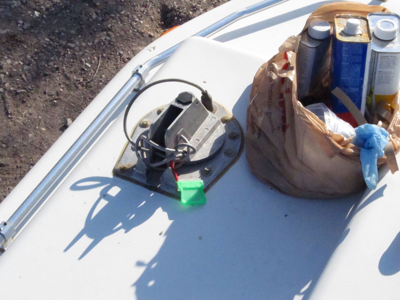

The base, with the floppy bits removed:

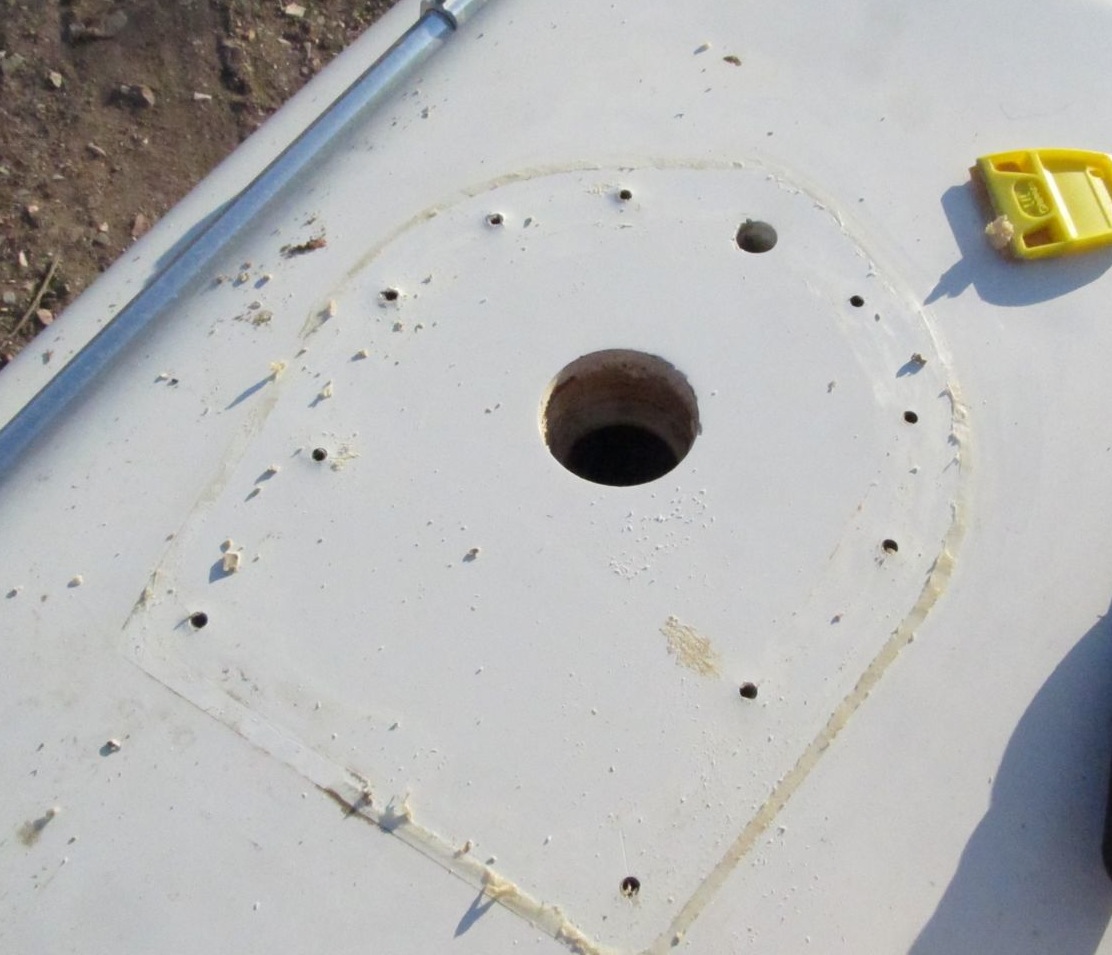

This is what the roof looked like just after removing the base. The ring of smallest holes are where the base was attached to the roof. See how the small holes are kind of "pulled up" a little? That's what happens when they aren't chamfered before driving pointy screws into them. It lifts and slightly cracks the gelcoat. Probably doesn't make it any easier to seal, either. If I were replacing/re-bedding I would chamfer each hole (which I also did before patching). This stops any further cracking, makes it flat, and also makes a tiny "well" for bedding compound (or if filling with epoxy provides more bonding surface.
The slightly larger hole is where the coax cable went in. The largest hole is where the gear goes through.
The thing in the yellow holder is a plastic razor blade. They come in three stiffnesses and are very handy for things like removing old bedding compound without making scratches.

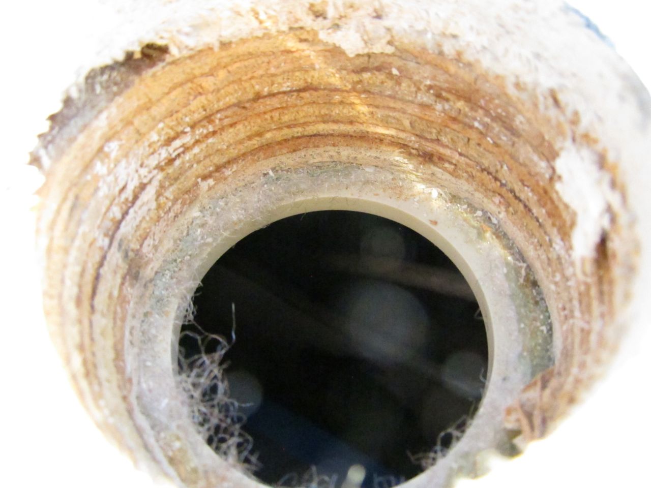

Here is a view down into the large hole where the main gear goes through to the crank handle that's inside the locker over the couch. Chinook used plywood reinforcing in a number of places (the regular roof where there is not specifically plywood has a plastic coring material - nida-core in my case). There is also an inner fiberglass skin, to which the carpet inside finish is glued (this all for my '99 Concourse).

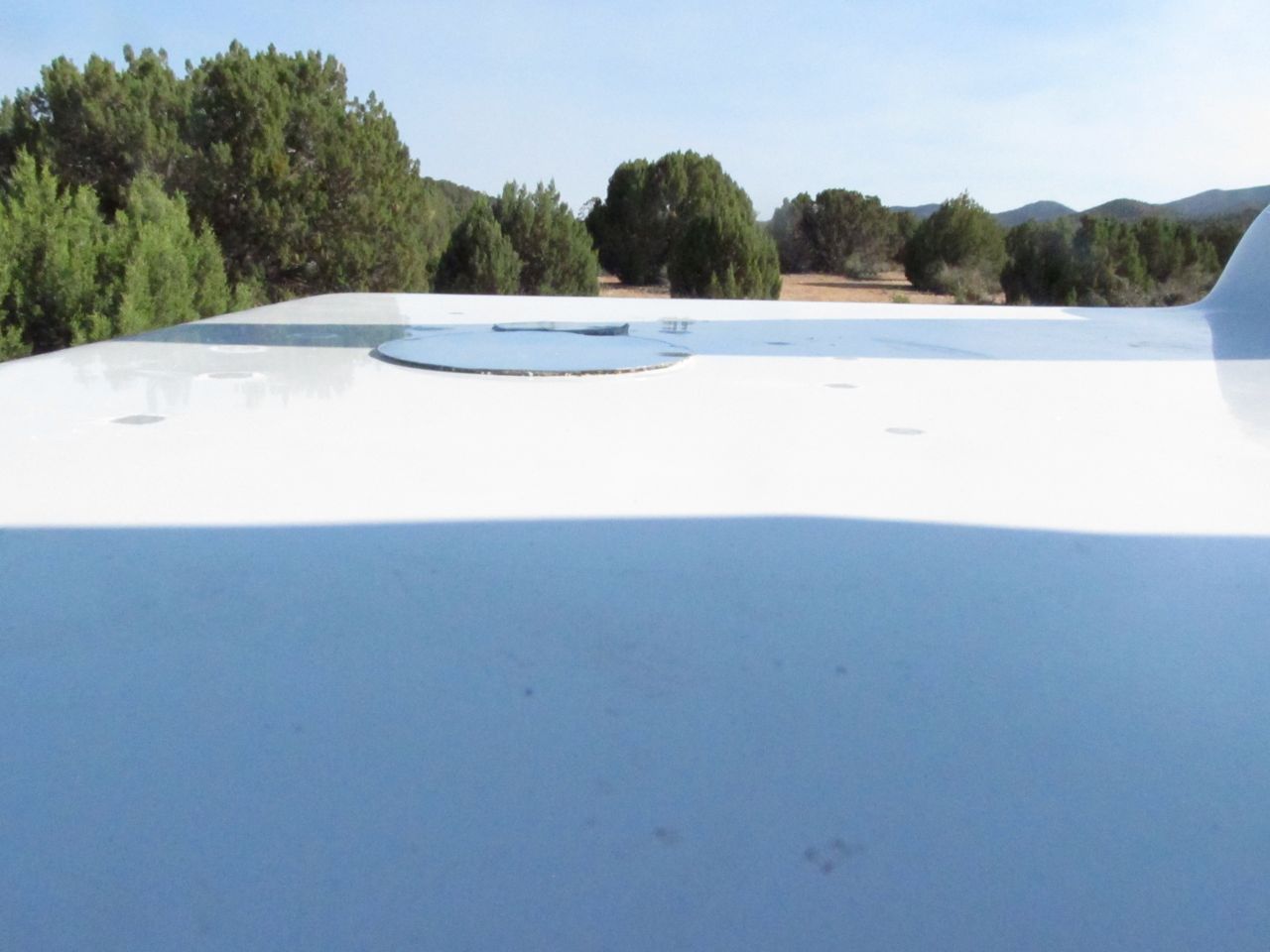

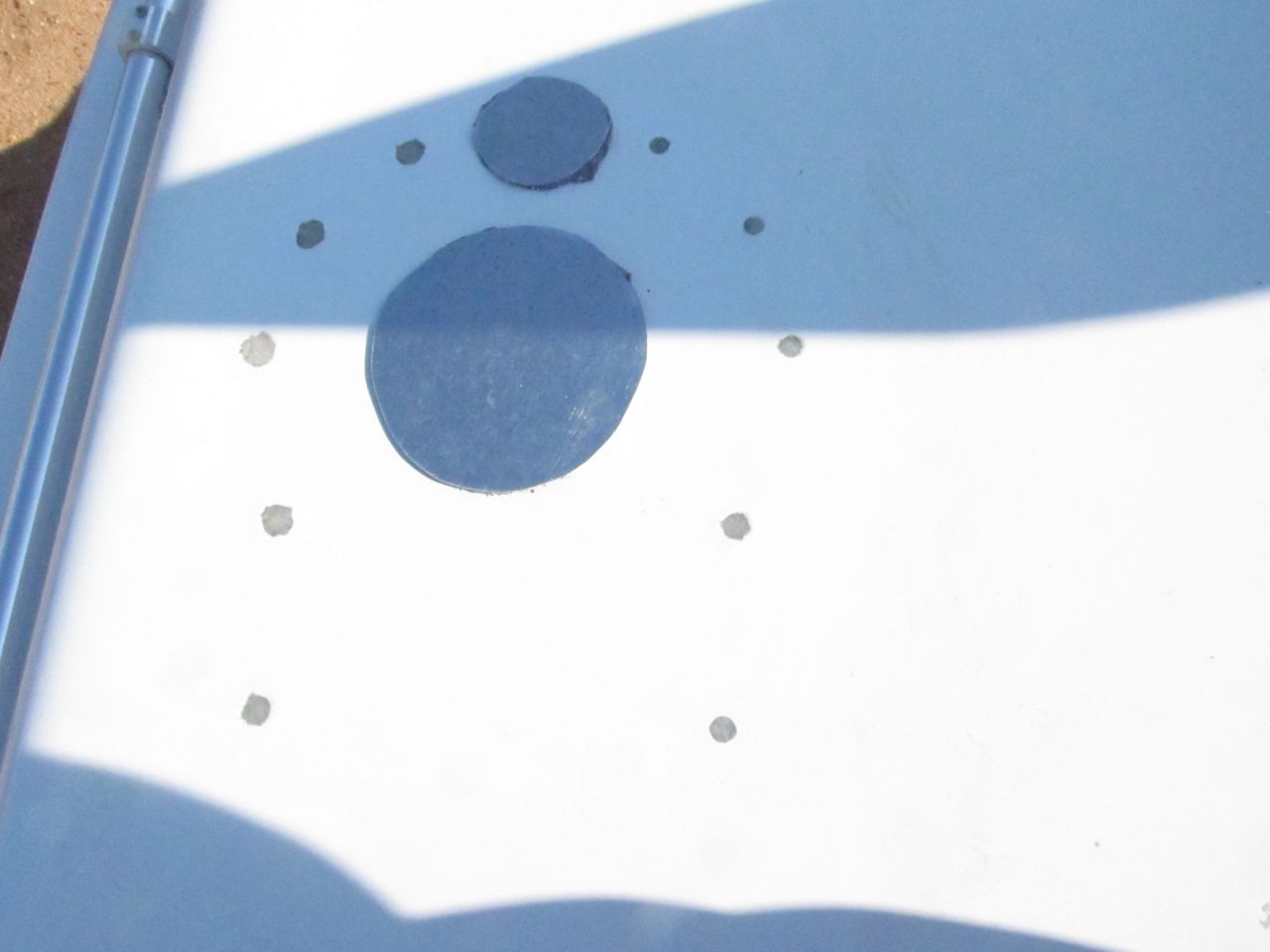

This next you won't be doing, but just in case it might be of interest to someone else reading. This is the roof after I filled the attachment holes with thickened epoxy. This is now "good as new" and watertight. The only thing left to do after this is finish it how desired. Most "proper" would be matching gelcoat, but since the roof isn't really on view one could paint it instead (gelcoat can be a fussy art). The main thing is to cover it somehow as epoxy will deteriorate if exposed to UV. For both gelcoating or painting, it's good to let the epoxy cure for awhile, so I generally put some blue tape on to protect it during that time period.
The two metal patches are because I thought I might use those holes in some way for my solar install. They are made of flat galvanized flashing cut in circles that overlap the roof an inch or so all the way around. Then they are sealed/held down with good (has to be the good stuff) butyl tape. This is a great way, IMO, because it is sturdy and water-tight, but also easy to remove when you want to do something else (use the holes, fiberglass them closed for good, etc.)
Here you can see that the holes that were filled with thickened epoxy are now completely flush with the roof. They are "one with the roof structure" now. (The perimeter holes, obvs not the metal patches.)
