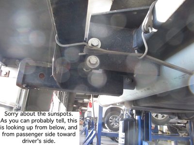

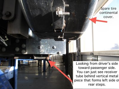

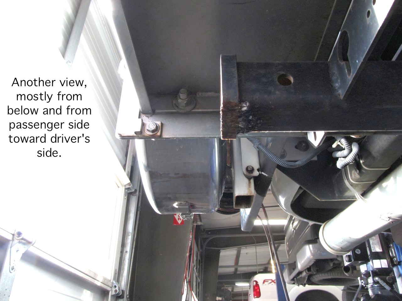

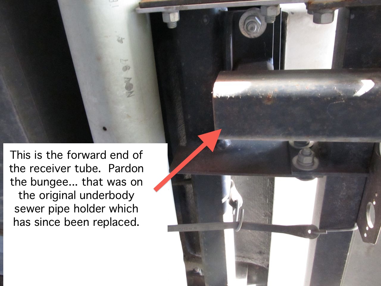

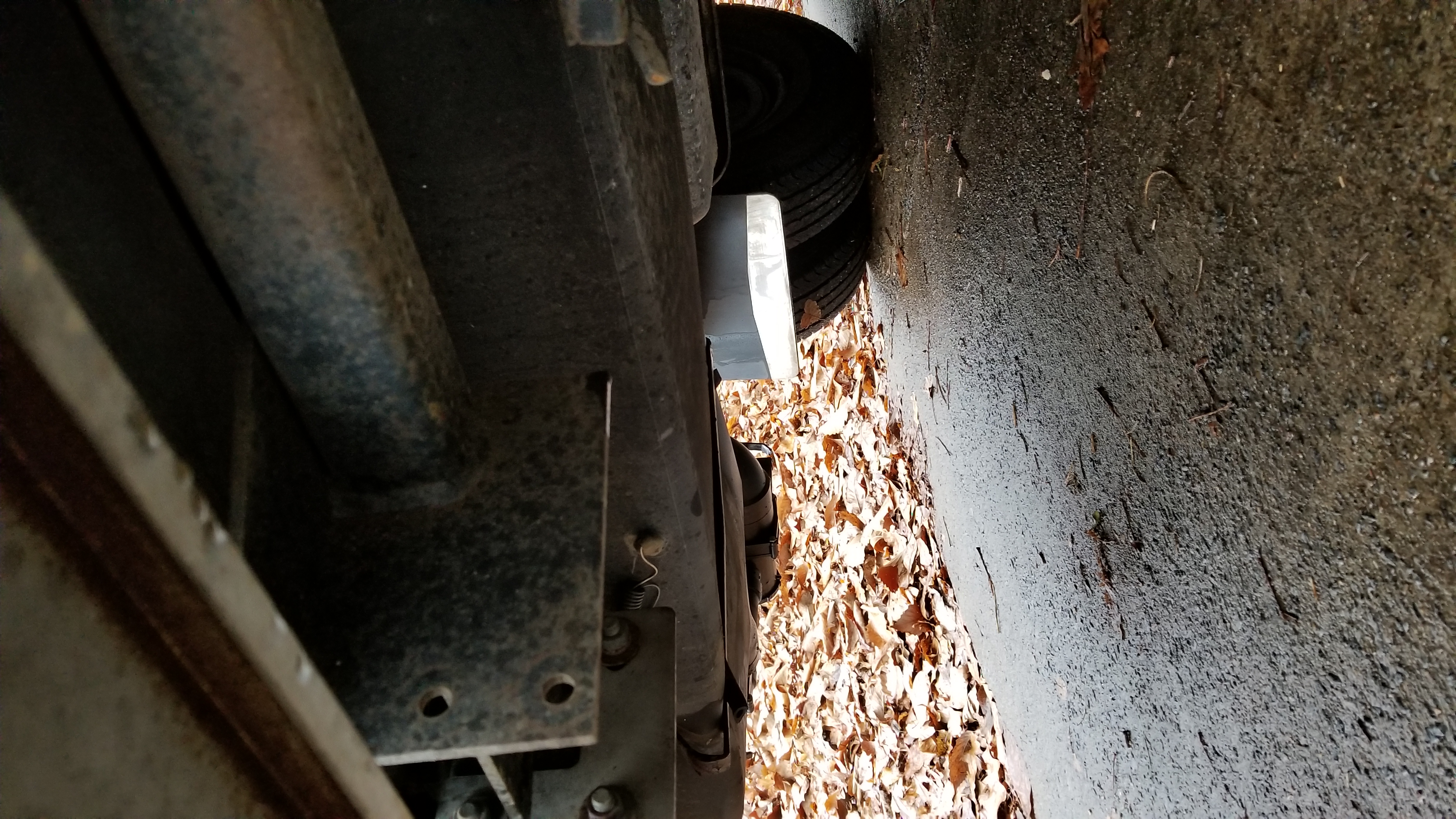

Here are a series of photos that may help. These are the stock setup on my 1999 Concourse. Aside from the first one, the rest are taken looking up while my Chinook was on a hoist. If I can clarify anything, just let me know. I could also take additional photos as I'm sitting on the Chinook sofa typing this :D
A few more in the next post.

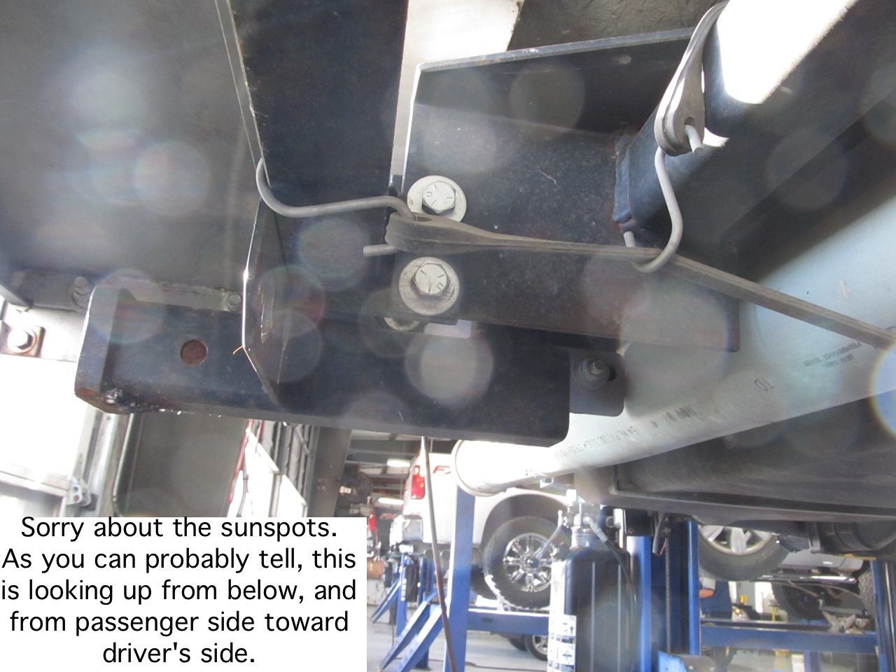

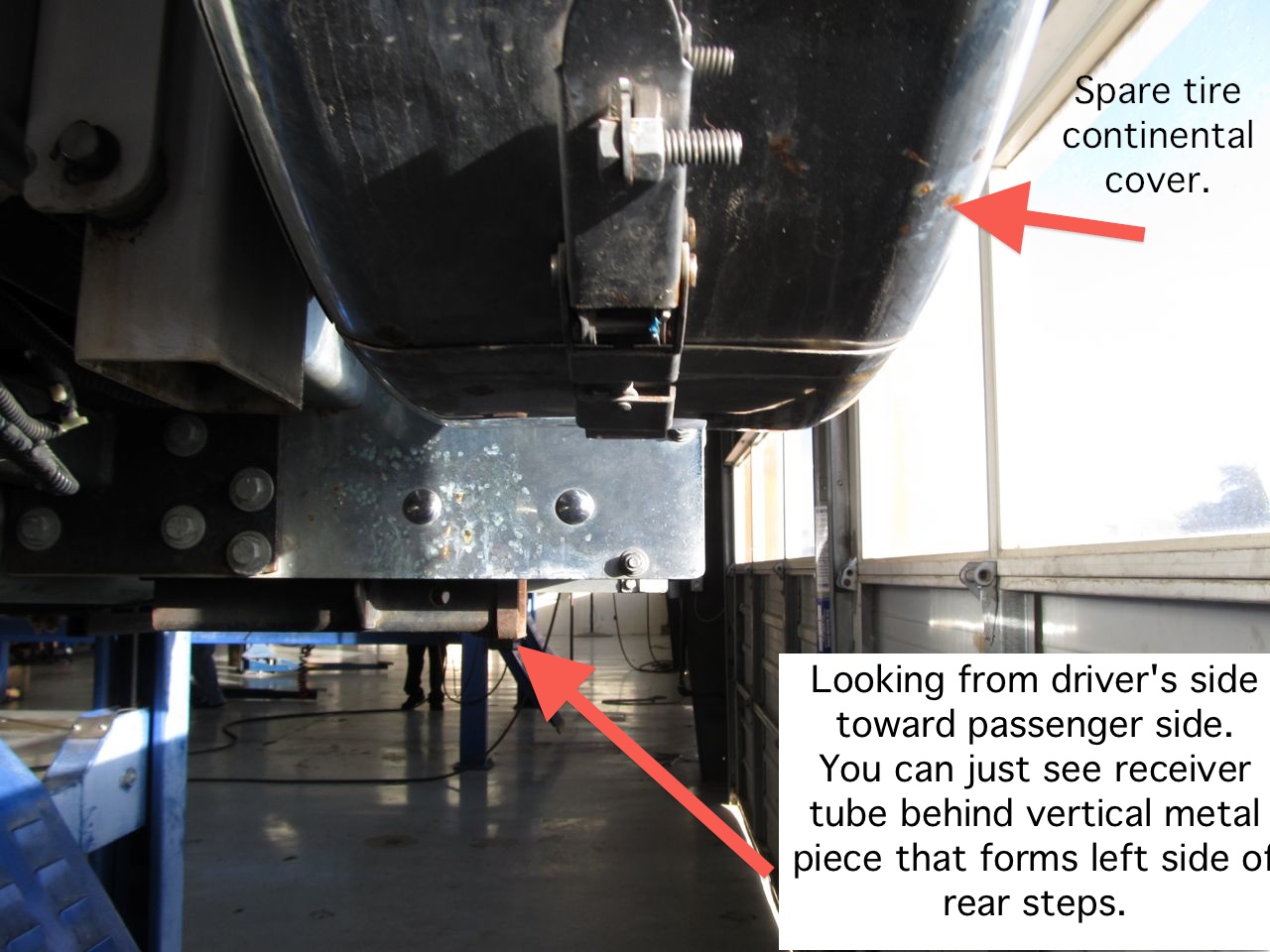

Re: What type of receiver hitch is installed?
I meant to note that my Concourse has the manual rear step. I think in all of the photos above the lower step is flipped up on top of the upper step (i.e. driving position). Things are a bit different with the electric step that came later, I believe (and earlier.... I don't know about either).
