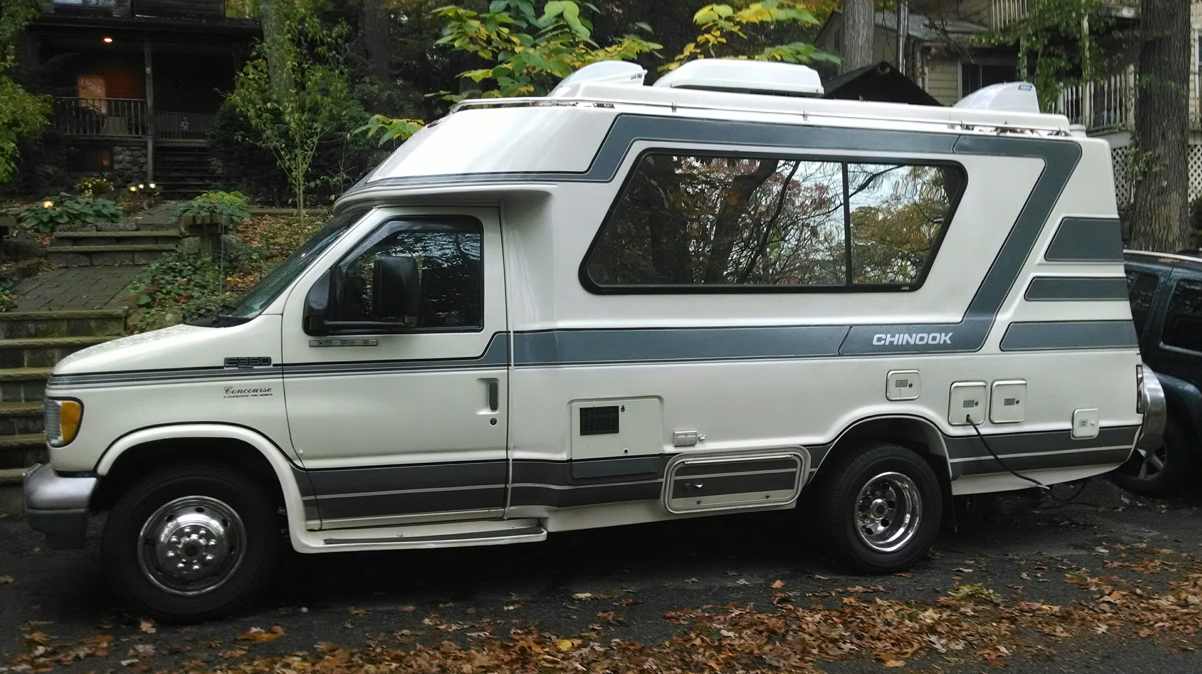

So I was looking at Ford Chinook photos, when it suddenly hit me that they all have a mid belt indentation down the entire vehicle.
Perfect place to put a reflective stripe! I thought. So I ordered a thin roll of silver-white 3M reflective tape, and put it in the groove. As you can see from the photos, it's nearly invisible in the daytime, but very visible when lit at night:

The cool thing is that the angle it's placed at doesn't matter. It always reflects straight back to the light source. Here, that means the camera seeing the reflected light from its flash.
The downside is that most approaching cars' headlights are lower than the Ford belt line, and thus don't reflect back as much to a driver's eyes. So I think I'm going to add another reflective line lower down.

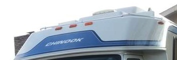

Made my own replacement Chinook decals from permanent sticky silver reflective vinyl. Took about five minutes for the Cameo to trace the outlines of four sets with its tiny blade. It cuts through the vinyl but leaves the paper backing. You weed (remove) the unwanted material with a pick. Then you lift off the remaining pattern of letters onto a sticky transfer sheet, from which you then press them onto the target surface. I put them on today and just took a night flash photo:

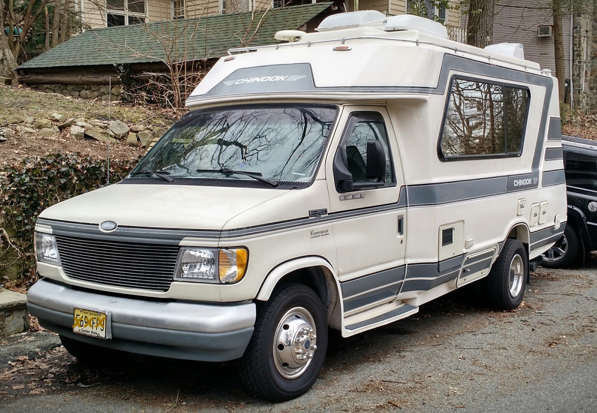

So when it warned up to 50F today (just before we get another 3-5" of snow tonight) I cut out more reflective vinyl lettering and installed it.
Yes, I went a little art deco with the wings :D

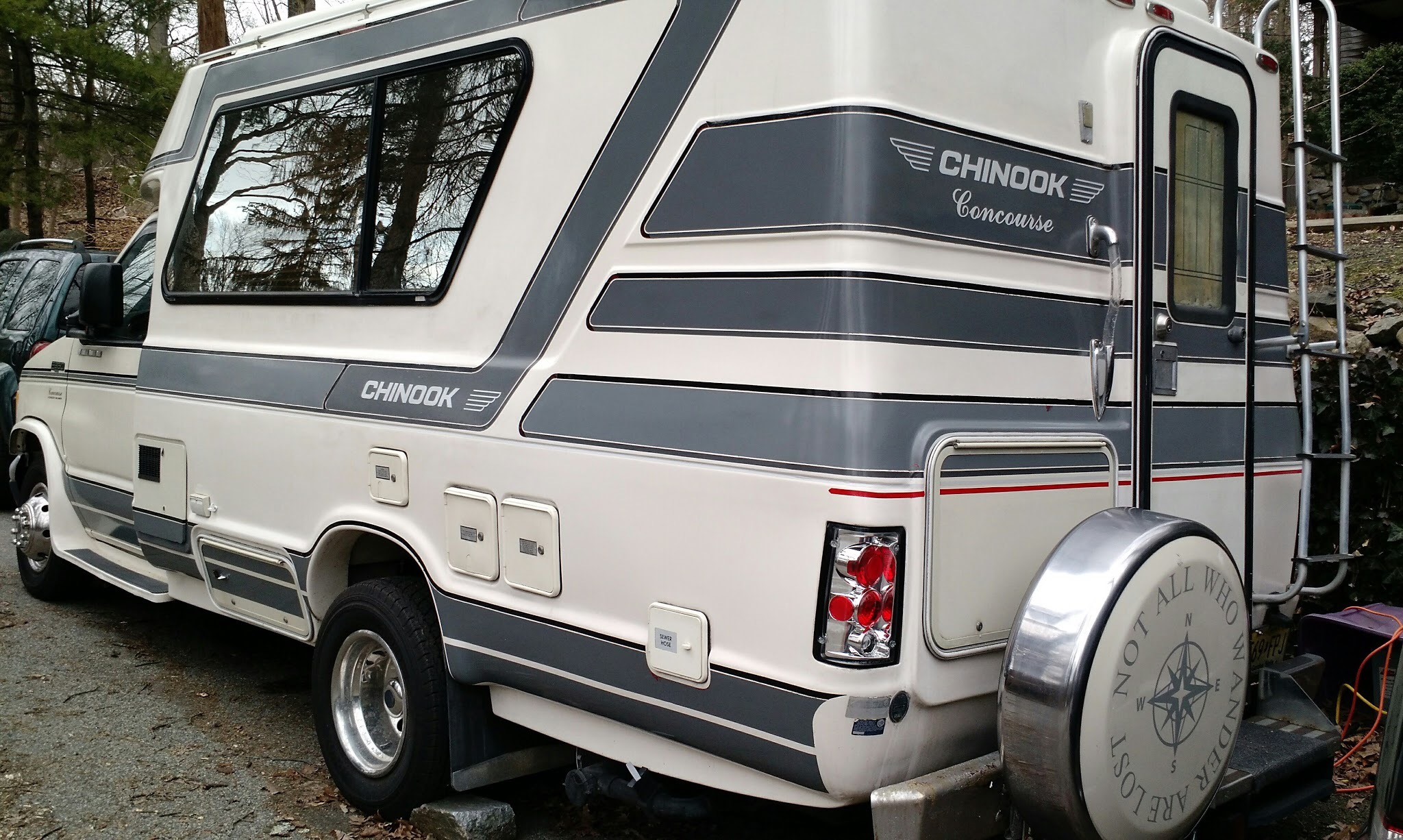

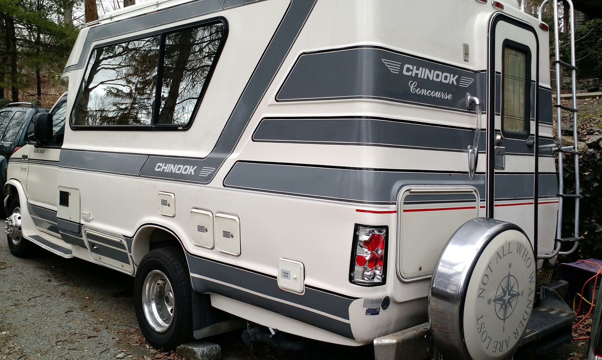

Also added "Concourse" to the back. It's from an enlarged scan of the ones on the front fenders:
