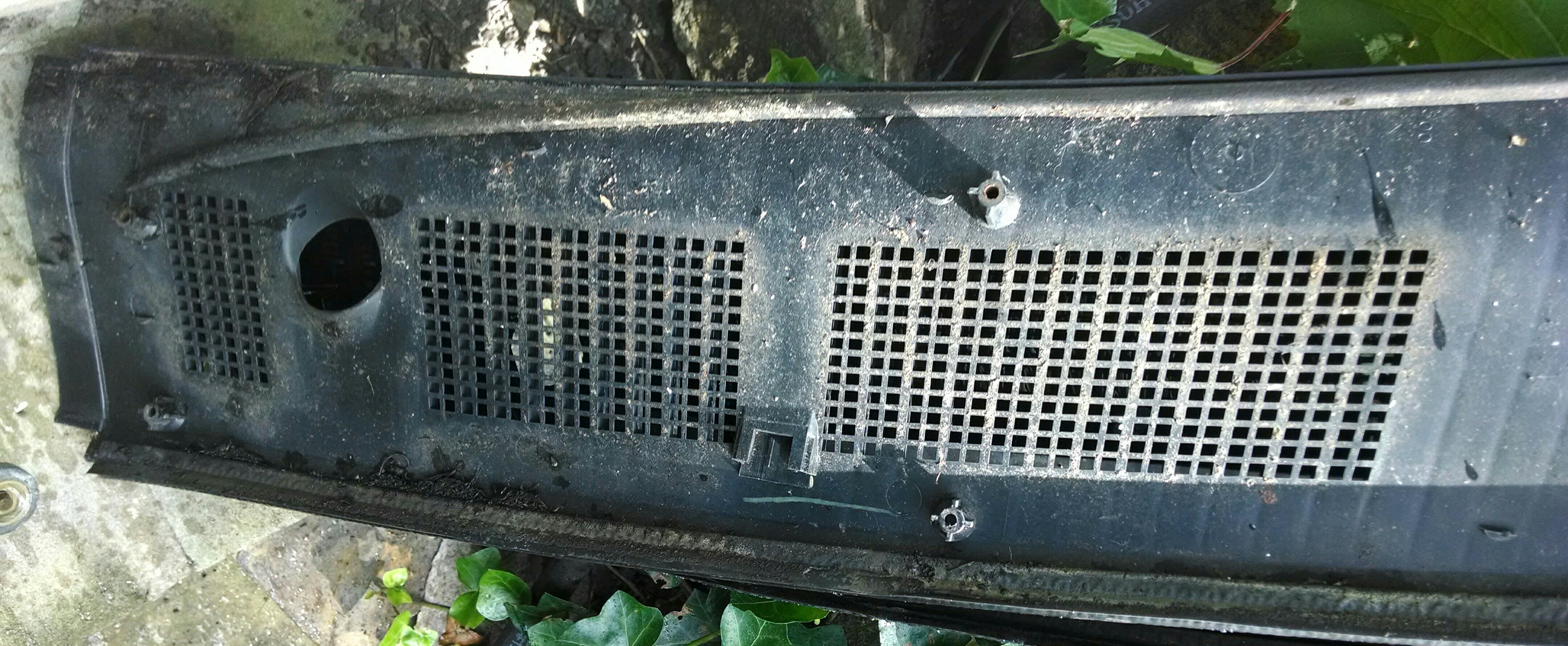

In my continuing quest to clean everything on this 25 year old chassis, my attention turned to my windshield cowl.
cowl
cowl
I had already repainted it and the wiper arms with flat black, which makes them look like new.
But I got curious as to what crud might've collected over decades under the cowl, and probably also helped make the AC smell a bit musty.
So, I removed the wiper arms (lift a lock tab and pry up at the outermost rim) and the twelve #8 x 1-1/4 black automotive trim screws. Then the driver side cowl half lifts first. Watch for sprayer hoses.

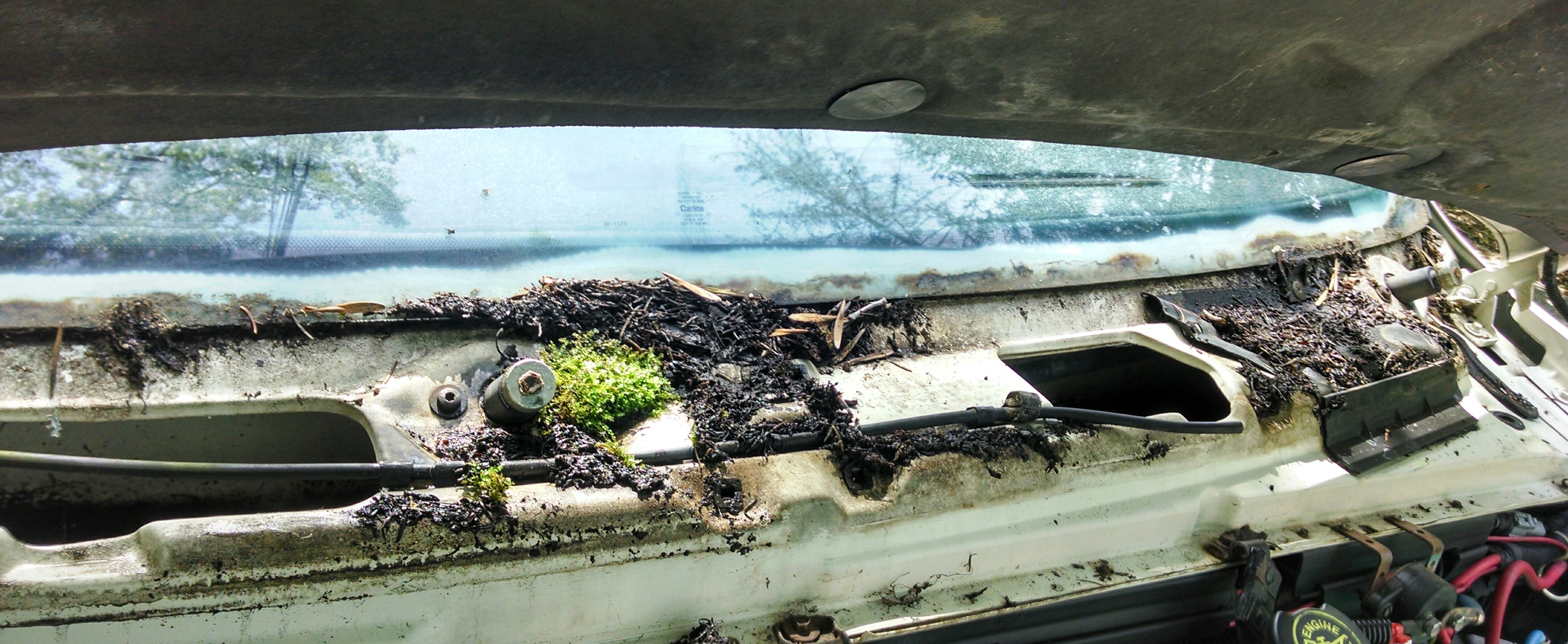

O. M. G. It was like a mini terrarium under there :lol: Took lots of scooping to clean that and all the collected muck out from down in the openings.
dirt
dirt
Note the rubber sheet and plastic shield at the right which protects the wiper motor underneath. At least they were still in good shape.

Just wanted to mention that there's only one cowl drain (that I could find); it's on the driver side. It's a funny little vertical rubber flap that allows water to drain onto the fender liner then run down to the ground. The drain was packed with compost and not doing its job. Also, if you're already into the cowl, might be worth the extra time to remove the fender liners to clean in there as well. My cowl cover is slightly warped and the weather strip from Ford was doing nothing, as your photo shows. I'm thinking of either replacing the cowl covers ($200 ebay) or installing some (much) thicker weather strip.
Re: The Horror! aka Under my Ford Windshield Cowl
Ours wasn't quite that bad but similar with those maple tree whirligigs. The other place they got was on top of the motor under the intake. I must have removed a pound or two with the shop vac. Never dreamed so much crud could accumulate there. :lol:

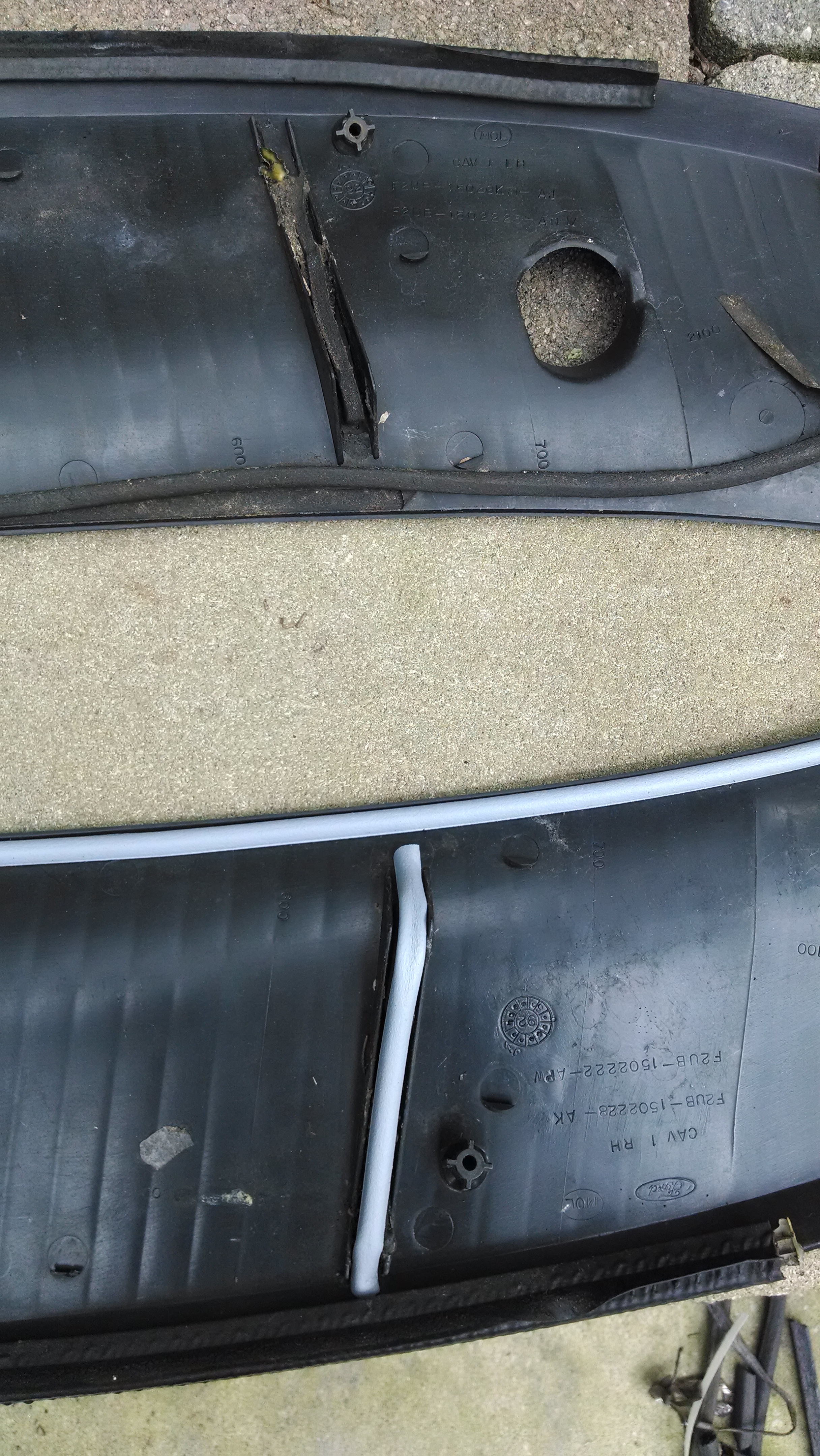

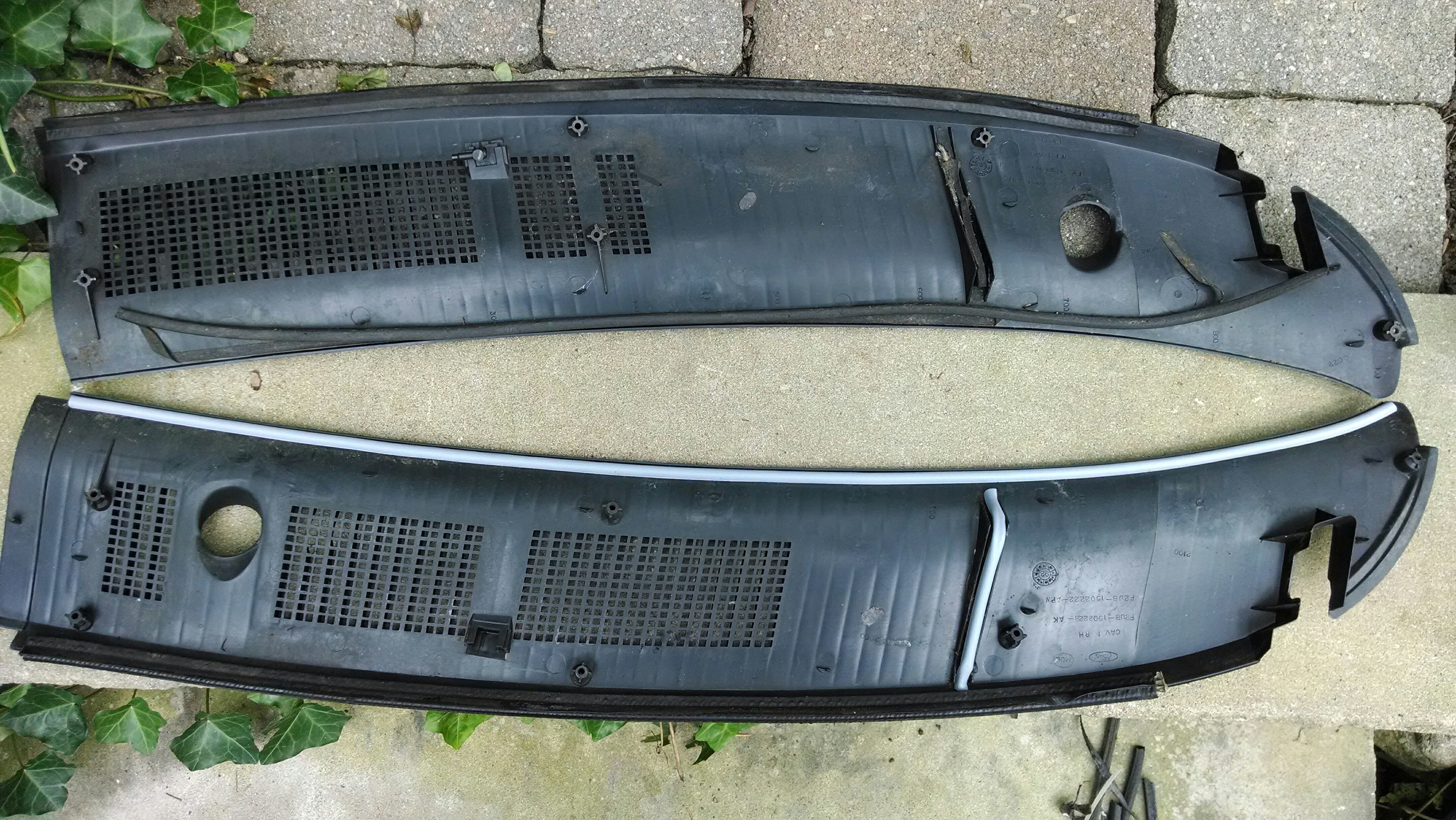

And here's pics comparing original and new::
new2
new2
new3
new3

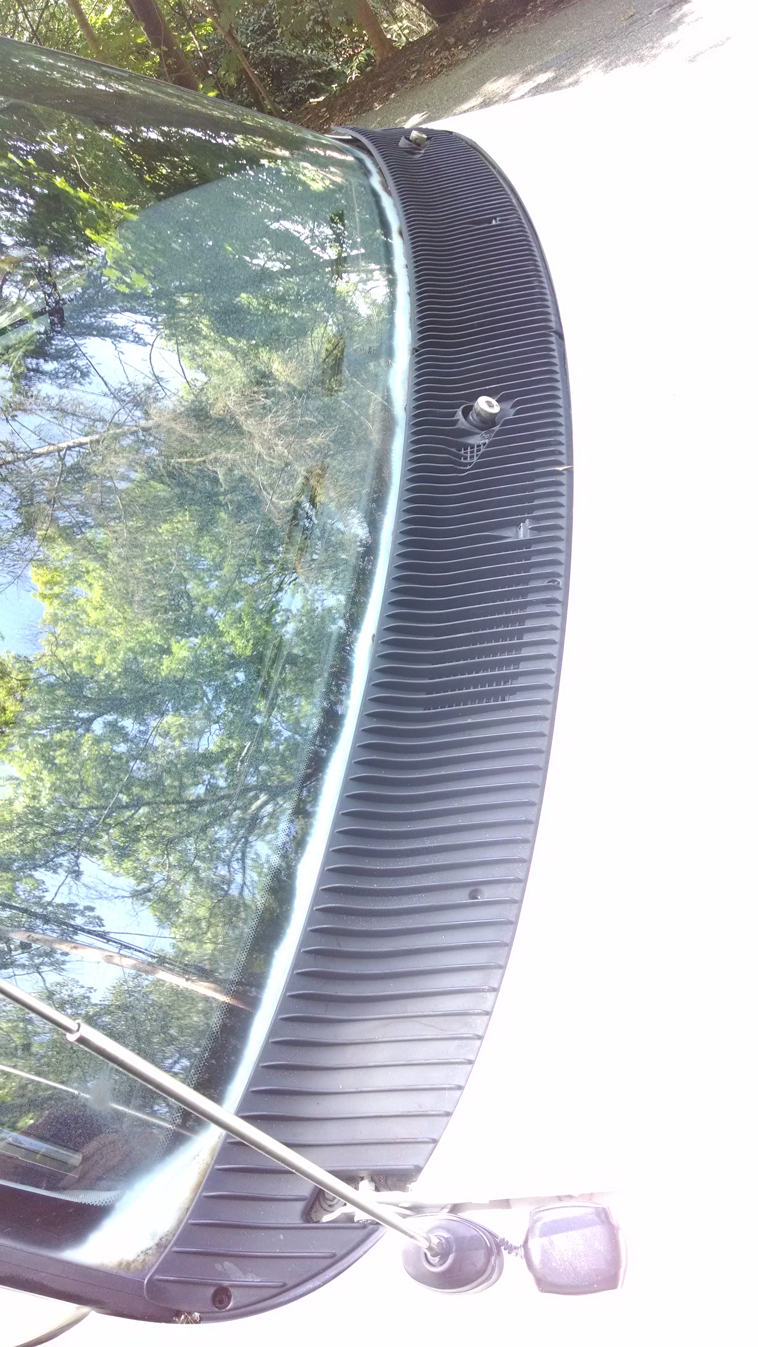

I'm not ready to remove the cowling to investigate under, but the top fins of mine look dull and dry. What is a good treatment to protect whatever it is made of? I have spray Armor All which would be much easier to put on than something wipe-on. Or should it be waxed along with the rest of the RV?

Anything plastic/rubber I'd recommend 303 protectant*. This returns plasticizers which leach out over time. You can use it on plastic, dashboards, tires, etc. Armorall contains silcone last I checked, and so I don't put it on anything. Ugh. Plus Armorall leaves that super shiny/slippery/greasy look and feel (gawd, I once bought a used car wherein they had Armoralled EVERYTHING. You were taking your life in your hands just putting weight on the floor mats - it was all ridiculously slippery (and thank to the silicone, good luck getting it off).
*303 now makes some more specialized things like fabric guard, but you want just the basic 303 protectant. A note is that it's supposed to have a two-year shelf life. I don't know how "strict" this is, and there is no date on the container, but for me I just don't buy a 55-gallon drum to last a lifetime, but rather buy smaller containers and re-supply from time to time.

Blue, thanks for the 303 Protectant recommendation and info. It sounds like exactly what I need. Had heard that Armor-all isn't all that good, and I don't like it much, but did not know what to use instead.

Jeanie, is your cowl unscratched and still all black?
If so, use the spray.
If not, I'd mask off a couple feet in each direction and repaint it with flat black spray, so it'll look like new.
