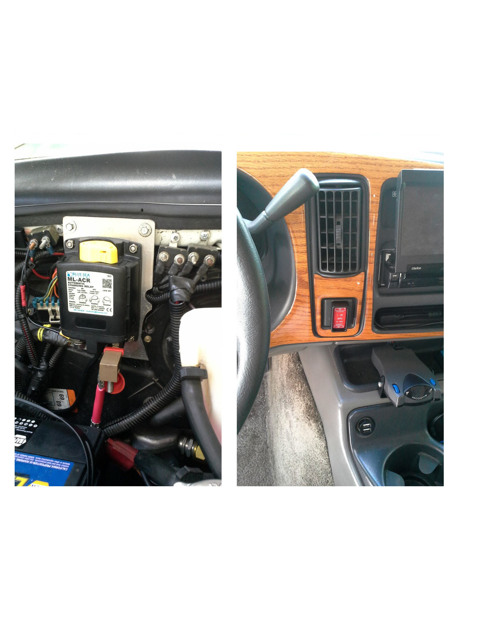

New to me, a Chinook Destiny. Not my first motor home but definitely, my first Chinook. All went well on our return ride home except no charge getting to the house batteries which seems to have made huge paperweights out of them. They will only hold slightly over 10 volts. Appears a PO removed the smart charger solenoid. Taking Blue's advice I have installed a Blue Sea 7622 with slight modifications to the wiring because of space limitations as to where I can install my MBRF fuse next to the chassis battery. I am still waiting for the fuses to arrive so, everything is not completely tied down yet.
Attached is a picture of the 7622 installed along with the remote switch. I am also including a PDF file showing pictures taken along with a copy of the wiring diagram from the 2003 Destiny manual and a modified copy of Blue Seas' wiring for the ACR. The name plate on the fuse panel below the galley indicates I have a Todd Engineering LC30. which I assume means it is designed to be installed in a coach with 30 Amp service. I would hope it's more than a 30 Amp charger.
According to the Chinook wiring diagram, it looks like all I need to do is remove the old converter/charger, wire a new one to the house battery circuit and plug it into the back of the AC panel. If I'm correct, the AC is already wired to that panel and I shouldn't need to do anything with it. I haven't stuck my hand way back into the cabinet yet but, I hope to find that the charger is at least screwed down rather than just laying there.
I'm looking for some guidance from someone who can confirm what I am actually looking at and make a few suggestions on how I might proceed. I haven't decided what kind of batteries I'm going to install yet so, would like to use a charger that will work with either AGM or flooded. The next question would be, if I install AGMs, will they survive when being charged from the old solar panel setup?

Yes, I mounted the 7622 in the engine compartment above the A/C and just behind the start battery. #2 cables were right there on an old starter solenoid that was wired to the "Boost", but not wired to the "key on" circuit, hence no charge for house batteries. I left the old solenoid there with only the control circuit from the "boost" wired to it. If I had mounted the fuse holder on the battery instead of the ACR, there wasn't enough clearance to put the nut on the fuse terminal.),
