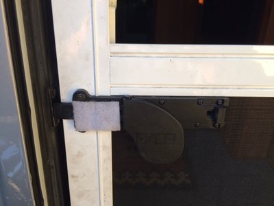

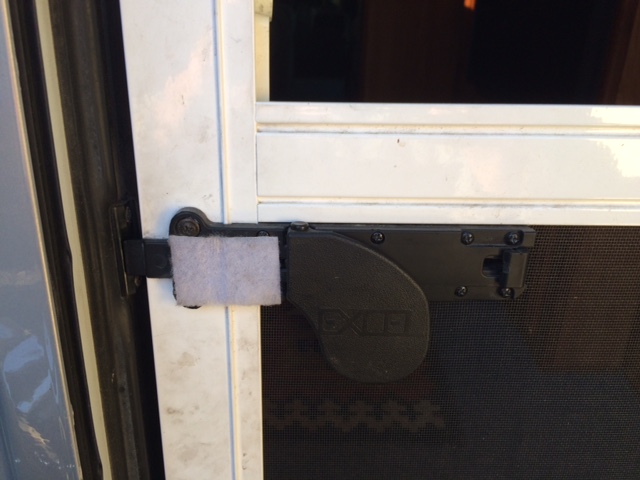

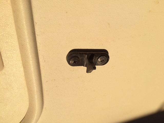

]JP--I just went out to check the type of latch I have on my 2004 Premier. It is not magnetic, but a "paddle" type screen door latch with a cut out for the actual latch in the frame of the door. It attaches to the main door via a "hooked catch" that is secured by screws to the main door at the right location so as to "catch" (via a square cut out) the paddle handle. I took a picture of both pieces and will attempt to attach to this post. The square cut out I am talking about can be seen at the opposite end of the paddle latch from the latch itself.
Let me know if this is the same system you have and I will attempt to get some more info from it so you can perhaps find a place to order one.
Re: Screen door 2000 concourse
JP...forgot to mention--the white patch you see in the paddle photo is a fuzzy piece of velcro...its mate is on the main door. I had a slight rattle of screen door that was bugging me and the velcro did the trick. Can't stand squeaks and rattles...my wife calls me the Squeak and Rattle Police! One of the reasons I shopped so long for a Chinook was that of all the rigs I looked at, it was by FAR the most solid. A few well placed sticky pads in strategic areas of the window screens were also required to meet my exacting standards!
