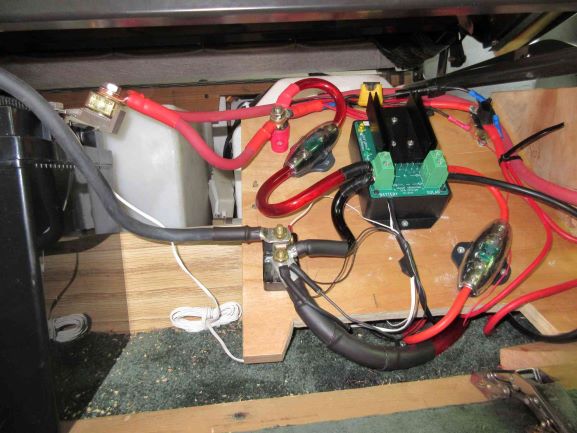

The batteries are newer Vmaxtanks 125 AH group 31 AGM's, fused at 200 amps, brought inside the coach as per Mr. Blue. I removed the LVD and put the controller, shunt, Blue Seas 7622 combiner, and an on/off switch to the brown box, near the batteries, see a photo. I relocated the 50 amp fuse there too, and the brown box has a Progressive Dynamics 4645 inside. The switch and combiner are to the right, out of the picture. I took the picture before I cleaned up the wire routing. I also replaced the chassis ground with 1/0 cable in anticipation of running 1/0 to the start battery.
In the course of doing all this I hoped to find and correct the fault that stopped the panels from charging the batteries. I could previously see 21 volts from the panels at the disconnected panel positive, but no amps would pass through the controller to the batteries. When hooked up to the controller, all I saw (see) is the battery voltage. This even though I discharged them some down to 12.7 or .8. I communicated with Bogart Industries and performed tests, and eventually was sent a controller replacement, even though the tech said it might not address my problem, as it seemed to be some fault other than the controller.
This was completed a couple of days ago, I inserted the 30 amp fuses and YAY, I saw solar charging. It stopped a few hours later when the sun set, and would not charge the next day....just like the original problem. I ran the engine and saw in the monitor big stupid amps charging. I tried the shore power, and saw charging, I ran the generator, and saw amps charging...but no solar amps.
It seems impossible, now that it worked for a few hours one day, for it to have quit the next. All fuses are OK, this should work, but does not.

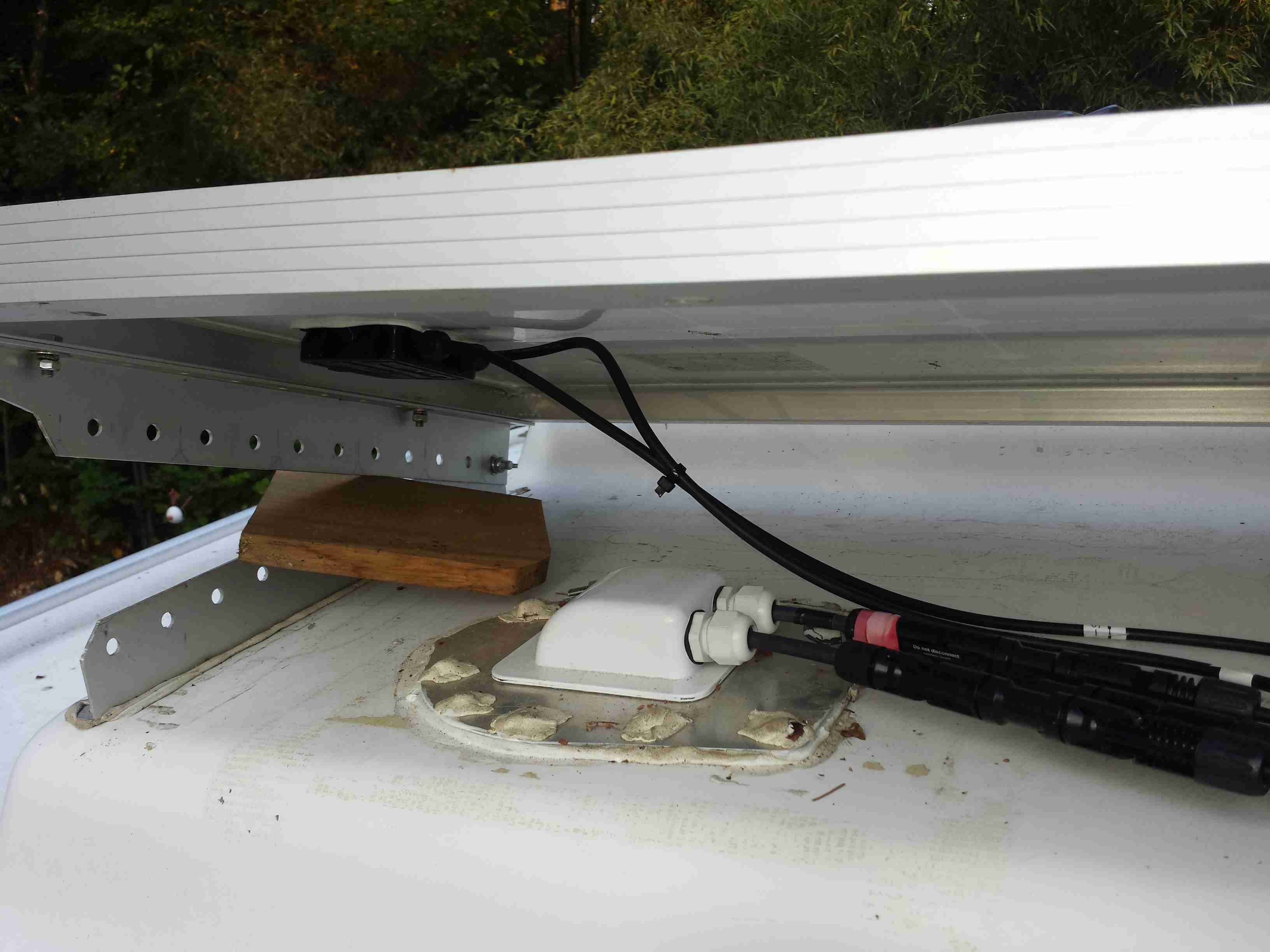

I obtained the two rigid HQST 100 watt panels about three years ago. It appears that my model has been superseded by somewhat smaller 100 watt panels on Amazon now. I read about 19 or 20 VDC on each, having opened all the MC4 connectors to ring out the cables. All the connectors looked good, I have no megger to check insulation resistance, but verified continuity. The 8 AWG PV cable is about as robust as I could get. The Bogart support tech, Kedar, thought that maybe the panel connections could have some problem. Other than that, the Bogart Industries TM 2030 monitor, where their solar controller is programmed, is one of very few remaining things that could be at fault.
Photo:
download/file.php?mode=view&id=5303
