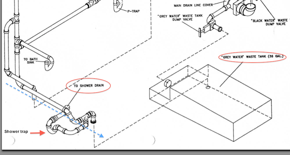

On the sink trap, no problem. It will be right there (it's already somewhat accessible from the tire locker). Shower trap I don't think so. I think access to the shower trap will require dropping the grey tank and doing it from below. It's crammed in right above the grey tank, and right under the floor, but not right below the shower drain. It's shown fairly well in this drawing from the 1998 manual:
The blue dashed line attempts to show the level of the Chinook floor. The trap is crammed up against it underneath. This is why I am very sure to put RV antifreeze in that trap if it's even going to get close to freezing! Not my idea of a fun thing to work on. That said, I'm going to be dropping my grey tank at some point and I'm planning to put on a Hepvo in place of the shower P-trap if possible.
