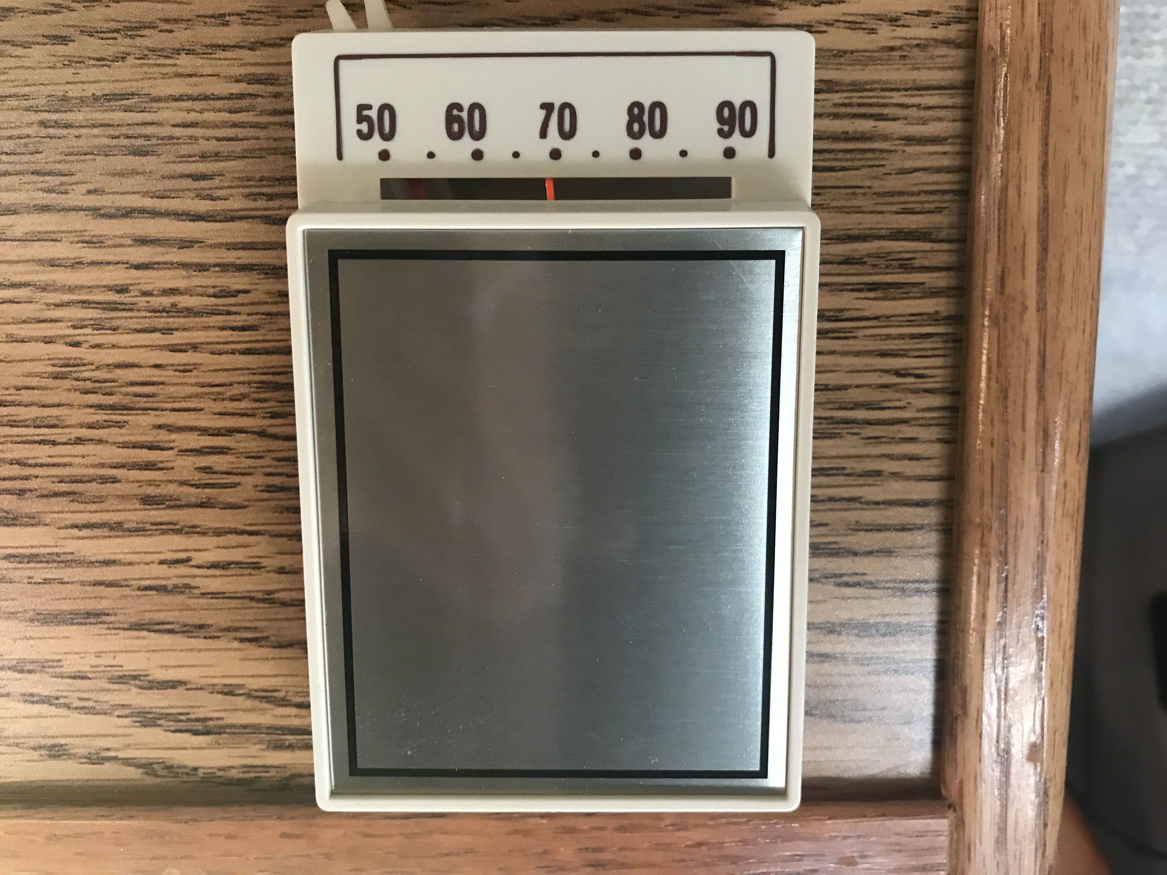

I’m starting to lean towards the two wire heat only hash mark Suburban thermostat.

Yeah I saw that...luck of the draw. It won't matter much now. The more I think about it, the more sense it makes to have a heat only stat and not confuse a potential future owner.

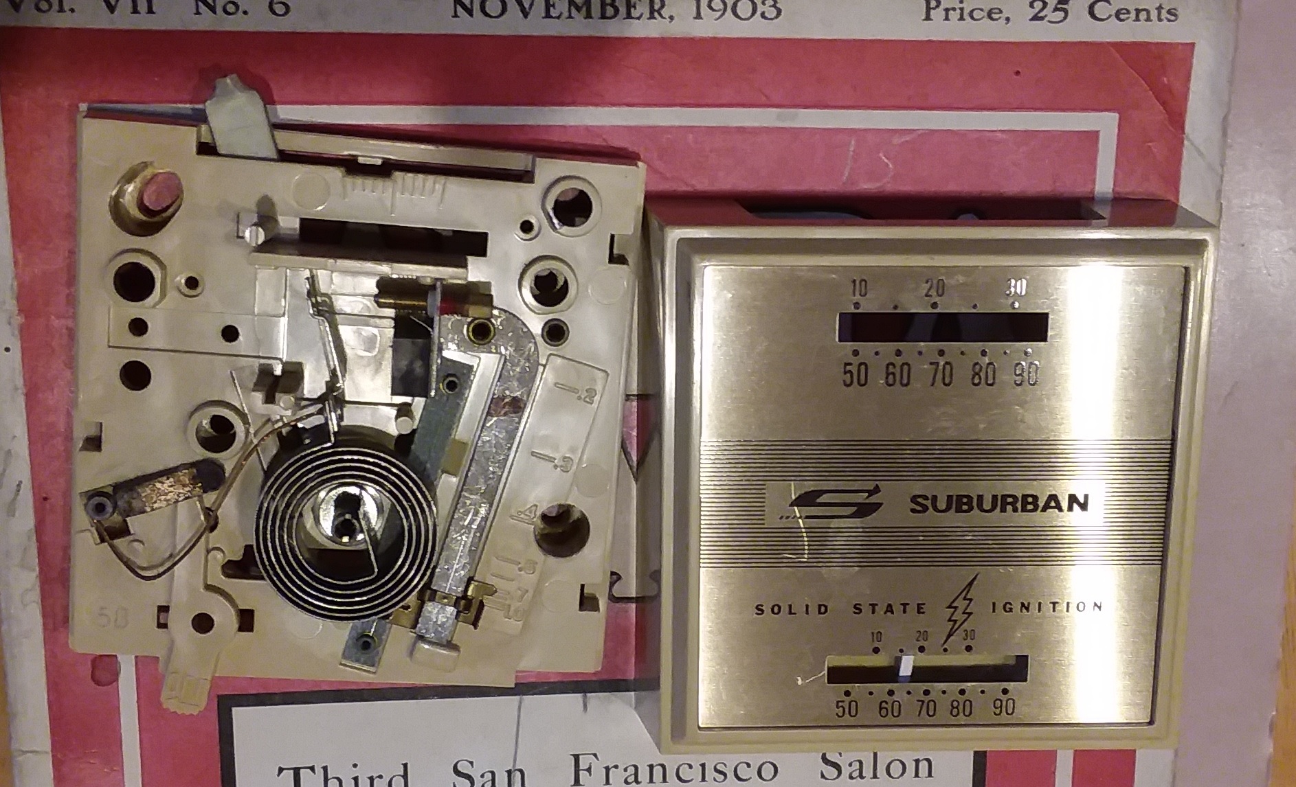

Pulled out of storage: a 2 wire 1994 Chinook's Suburban thermostat circa 197?. A pretty simple device. Clock spring, adjuster, and switch (bottom left). It can even be calibrated with the little red screw for those whom matching numbers matter. The thermometer is accurate to within 5 degrees! I should re-mount it just for the gold style-points. They had a design department, certainly.

Definitely a good looker, but alas, no on/off switch, same as mine. I will most likely end up getting the hash marked Suburban 2 wire one and paint it.
Re: Furnace in 2000 Concourse
The more I think about it, the more hash marks appeal. I mean, unless you move the thermostat it's practically up on the ceiling, and basically right above where the furnace blows out its heat. I bet 75º on the thermostat equals about 55º down where you living (40 in the shower). Not a problem with hash marks - just turn it up :D
