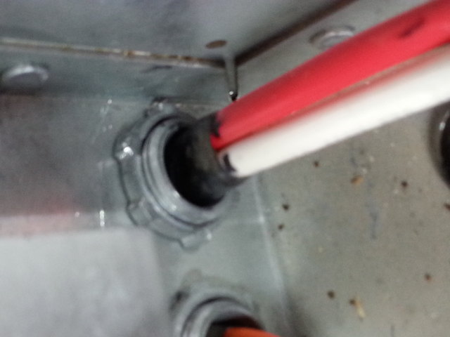

Mission accomplished!
Pulled fuses from the solar controller, had the house and chassis batteries disconnected, no beeping or clicking so I proceeded.
Went as well as I could expect. Tried to connect the battery wires without loosening the strain relief, (Clay must be a magician), removed the DC card, took off the strain relief nut and loosened to get about 5/8 inch more wire, it was plenty.
Have to thank all of you for this forum, it's a great resource for us, this job would have more trying without all your knowledge and help.
And Clay (caconcourse) I read your blog https://clayrushing.com/2017/01/21/chin ... -upgrades/ over several times, it helped me so much understand what to expect.
Thank You
The wires were wrapped with black tape at the strain relief, you can see how much wire was pulled through.
