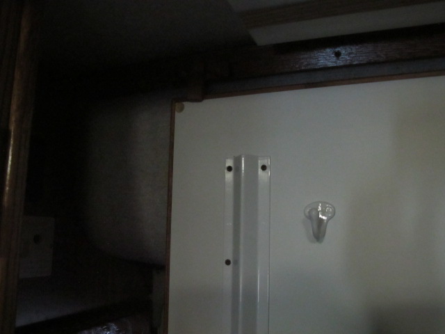

Here's a few pictures of the ceiling max wall bracket material I used for the shower door opening as well as a handy way of keeping the shower door open.
