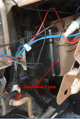

These are my notes when I programmed a second remote:
Remove the driver’s side knee panel which just pops of with spring push pins across the top and the bottom. Locate the Marksman keyless entry module (see picture). There is no Valet switch installed just the pins for the harness. Jump these two pins to put the module in programming mode. Did this using the tip of a pair of needlenose pliers. Jump the pins 6 times with the ignition on and it will put the module in Auto Channel mode which is the two-button config (one for On and another button for Off). Then push any button on one remote fob, there will be a relay click (the horn relay which isn’t hooked up) signifying the key fob was programmed, then push any button on the second remote fob (if you have one), and turn off the ignition for ten seconds.
Also see the attached PDF file official Marksman instruction sheet.
