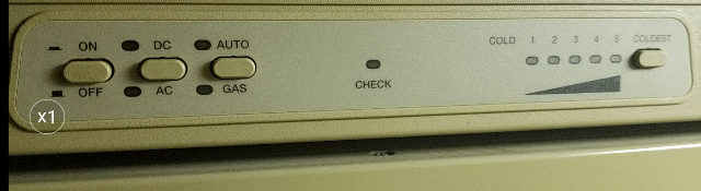

I found out on the start of my last trip that the refrigerator won't come on. It's been working great (and is original) but I haven't used it in a year. I've attached an animated gif but if it doesn't work here, I press the power button and the lights light up like they normally do. Then they all go out in about a second. Shore power or vehicle power,same thing. New board time??

Hmmm, says the file uploaded but I don't see it attached...
*edit* Here it is
Motion gif
Motion gif

Sounds like a control board problem. I heard one of the replacements is called the Dino board. You may want to give them a call and see if they can confirm the issue with the board.

Thanks. Are they somewhat easy to replace, like accessing it from outside the rig?

Skillet wrote: October 28th, 2018, 9:23 am Thanks. Are they somewhat easy to replace, like accessing it from outside the rig?
Yes. Just pay attention to the instructions, which are good. You may have to make a jumper wire to connect a second ground point on the new card to the existing ground, but that is the trickiest part. The Dino card seems to fix a multitude of circuit problems that occur with the original card over time.

Here is a link to the Dinosaur card on Amazon, in case you want it:
https://www.amazon.com/gp/product/B0002 ... UTF8&psc=1

You are awesome. I'm going to hit up the company by email to see what they think.

Back when I still had my propane fridge I experienced the same problem where it would act like it was starting and then would shut off. Dino board and a new thermistor fixed that.
