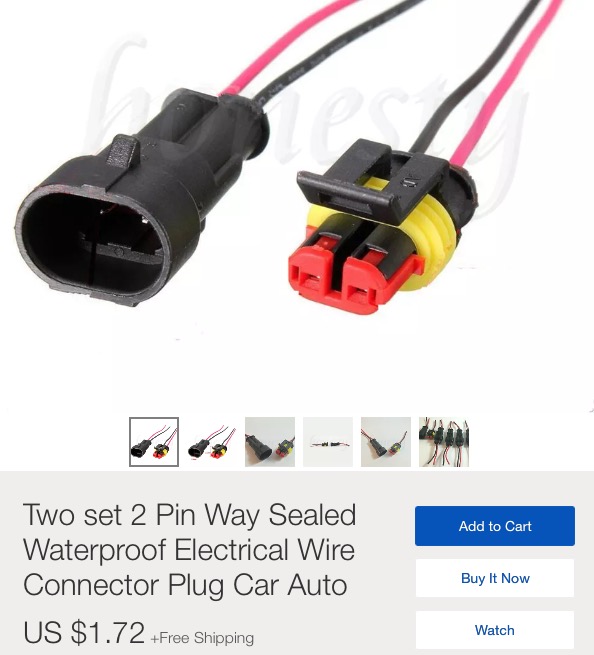

So in addition to the T-taps behind the turn signal, I recommend splicing another connector into the LED wires, but behind the headlight (leave enough wire to pull the lens out far enough to be able to disconnect!). That way, you can simply undo the headlight bulb connector and the new LED connector, both without having to remove anything else.
Being fancy-schmancy, I bought some two-wire waterproof connectors which I intend to insert in the LED wires just behind the headlight.
waterproof
waterproof
Of course, any kind of connector would probably do ;) But I often spray water to clean the grille.
