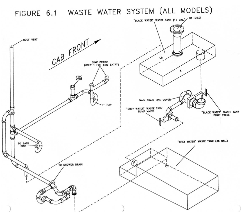

You've probably seen this, but here is an excerpt from the 1998 Chinook manual (I don't have the '99 digitized) that illustrates the general plumbing layout.
You may want to click to enlarge. This is also included (probably in larger format) in both the 1998 and 2000 manuals which I have uploaded to the reference sub-forum. Chinook's system drawings are something I've always appreciated (not all RV brand owners are lucky enough to get them).
