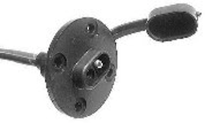

I noticed that in the 2005 manual, Chinook no longer published a diagram of the DC system. However from what I have gleaned, plus looking at the diagram they do have of the "brown box' area, I think there's a good chance it's similar to what I (and others) have. So I'll describe my original setup to you FWIW.
Starting on the roof, there was a 55 watt Siemens panel on the forward portion of the passenger side roof. It was held on with aluminum angles fore and aft screwed into the roof. Under the middle of the panel (invisible until you remove panel) was an SAE style connector with one half on the solar panel wires, and the other half screwed into the roof. Like so:

Roof half:
connector on roof.png (53.66 KiB) Viewed 2544 times
Under the flanged roof connector was a hole of about 5/8" diameter. The wire went into that and forward, between the roof and the ceiling (in other words it tunneled through) and came out in the ceiling of the overcab on the far passenger side, through a slit in the ceiling carpet. From there it went into the solar controller (such as it was...), which was in the passenger side of the "entertainment panel" by the passenger side stereo speaker (not sure where yours is).
