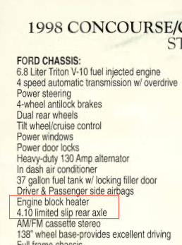

Roger D wrote:I guess I'll have to crawl under the rear with a flashlight and see if there is an axle tag showing the ratio and whether it's a LSD.
Well, lookie what I found. The 1998 Concourse specification list shows the Limited Slip rear axle and the block heater on even the "basic" Concourse. I'll have to look in my '99 brochure and see if it is still listed (I have that, but only on paper and it's not immediately grabbable). So you have Limited Slip and I may have a block heater (if it's still on the '99 list) :)
LS axle.png (126.46 KiB) Viewed 3843 times
