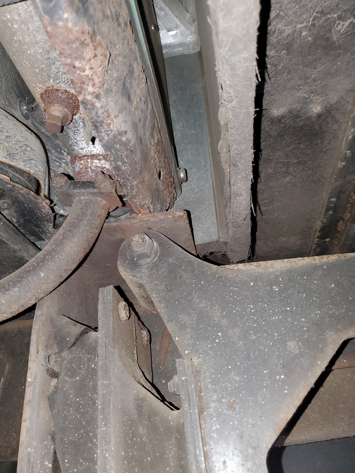

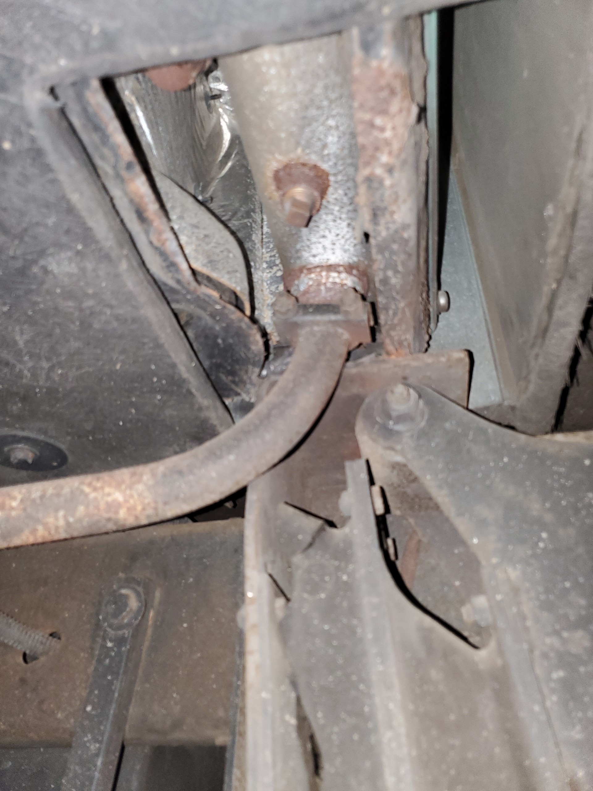

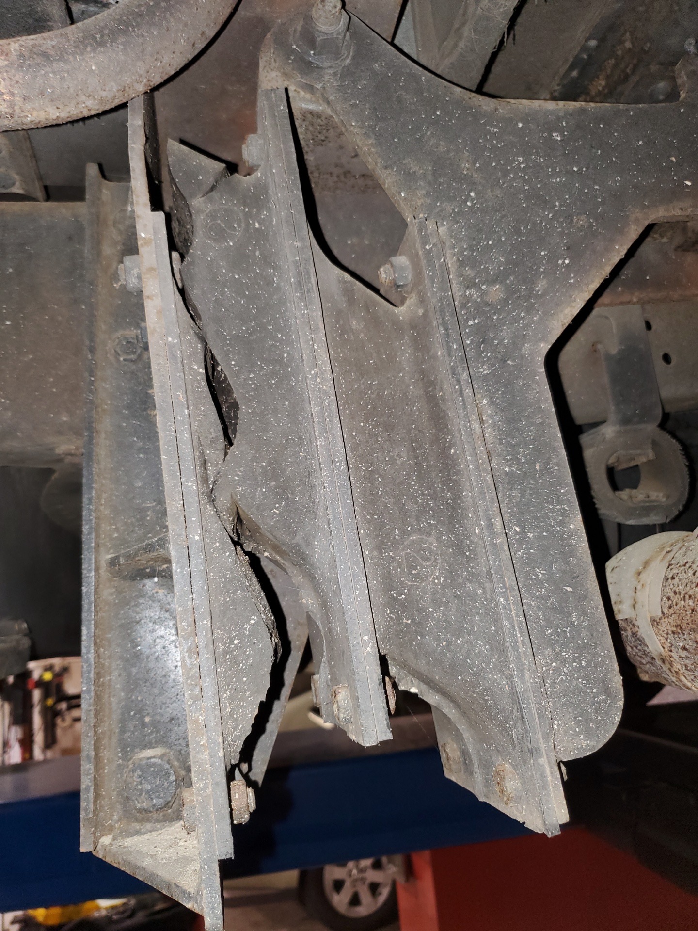

My sis's 2001 Chinook 24 footer has apparently broken some pretty odd looking mounts on the rear suspension. They look like three pieces of steel, with rubber inserted between them. And the rubber has come unglued or whatever.
I have some pictures of the mounts, but will I'm not sure how clear they are.
We can't seem to find these anywhere. Anyone had this problem, and found a solution?

That's the "MORryde" suspension system. You find this thread interesting:
viewtopic.php?f=13&t=1476
Re: Coach mounts broken?
Yup, the classic MorRyde.

You're right, that's the best info I've come up with in a couple of weeks of chasing this thing.
Does anyone happen to have the contact info for this MORryde outfit? Sounds like we need to chat with them.

MORryde is still in business, and a google search yield the following: https://www.morryde.com/

i just switched out my moryde to Weldtec front and rear suspension, and lifted..might be worth the upgrade instead of going back with that. or you could just go with normal leave springs, but not sure about front to rear ride heights.
good luck
