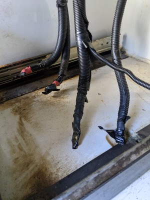

Wires hanging down into battery drawer.

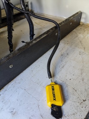

The yellow box on thinner wire

I connected to the batteries in parallel as shown. Which side do I connect the "yellow box" to?

My picture labels (pic 1 and 2) are switched but I hope you get the idea. The inside battery control panel reads batteries fully charged (the repair guy charged them) and reads 13.1 v.
The yellow box concerns me. I attached it to the "farthest negative terminal in the series" per guidance I found on YouTube (before I read about this forum and quit trying YouTube).
From your comments, this may have been a mistake, What is it for? Which terminal should it be connected to?
Re: Guidance to install coach batteries
Posted: December 29th, 2020, 7:11 am
by dokramer@live.com
Ok, per Xantac inverter manual
"You can mount the Battery Temperature Sensor in one of two ways:
• Mounting the sensor to the negative battery post allows the internal battery
temperature to be sensed and provides the most accurate results
I think I'm okay, i connected to a negative battery terminal. THANKYOU for your help and guidance!
Posted: December 29th, 2020, 7:28 am
by BobW9
Sounds good. Glad to see that picture, I was not thinking of a temp sensor because I'd never seen one big and yellow like that! I did look online and agree with you that putting it on the negative seems to be what Xantrex does for their sensors.
