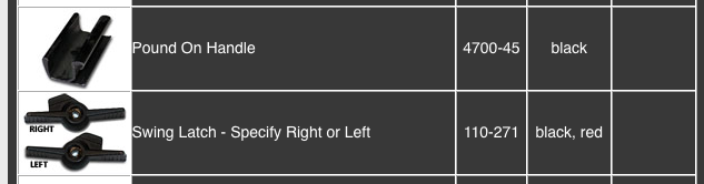

To start with, the handles (not the locks) are the Hehr "pound-on" handle, and they have an associated number of 4700. At least I'm pretty sure that is the handle (I still have all four of my originals). If you look, for example, at Interstate Metals at part number 4700-45, I think that is our handle. You can scroll down on this page:
http://www.interstatervmetalandsupply.c ... ndows2.htm
Note the lock lever just below that pound-on handle (more on that below)...
So on Parkin's page, I found both our discontinued screen clips (I called, I begged, they don't have any more), AND the apparently discontinued lock levers (the windows themselves are no longer made so parts aren't supported by Hehr). For reference and search purposes, that style of lock lever is called a "sweep" latch or lock.
As you will see in the photo below, they show "our" sweep as discontinued and say to use the one below it (which is commonly available). I'm not sure how well or if that one will work.

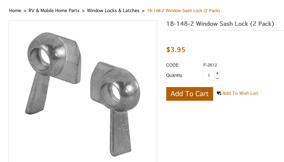

On the other hand, I found a common metal sweep that does look a LOT like ours at windowdoorparts.com
Might be worth ordering to try (I also saw it in other places, just don't have time to continue the search at the moment). Not sure if it is the same thickness, etc., but it sure looks veeeery similar (might not break like the plastic ones either - what happened to my one that broke is the little tab snapped off the body).

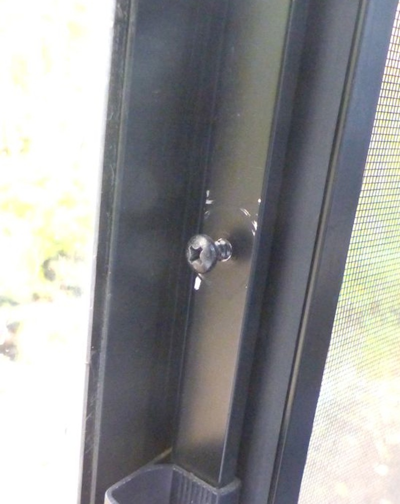

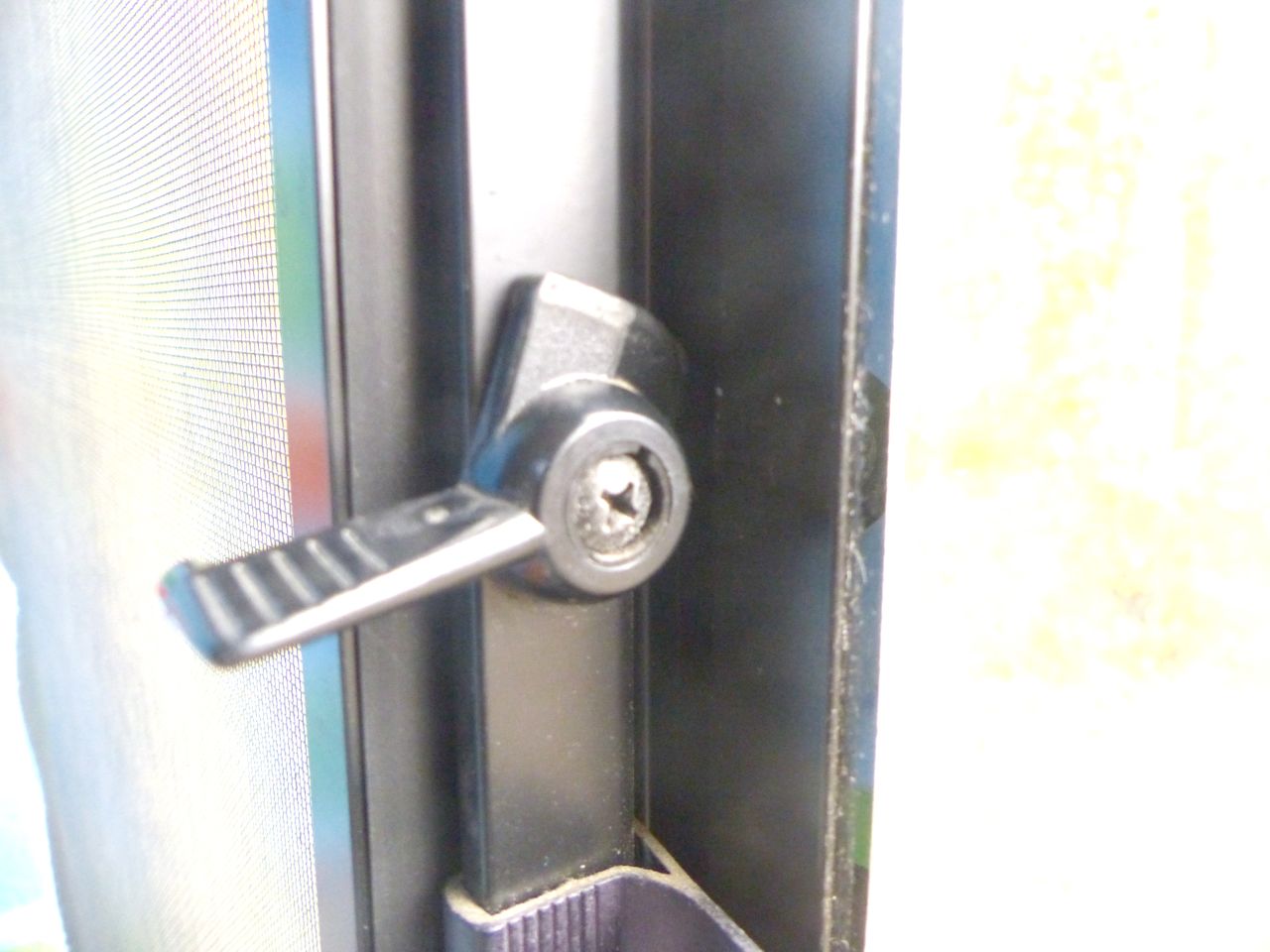

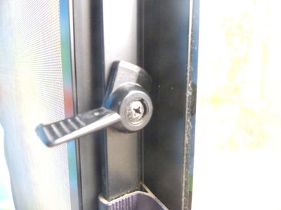

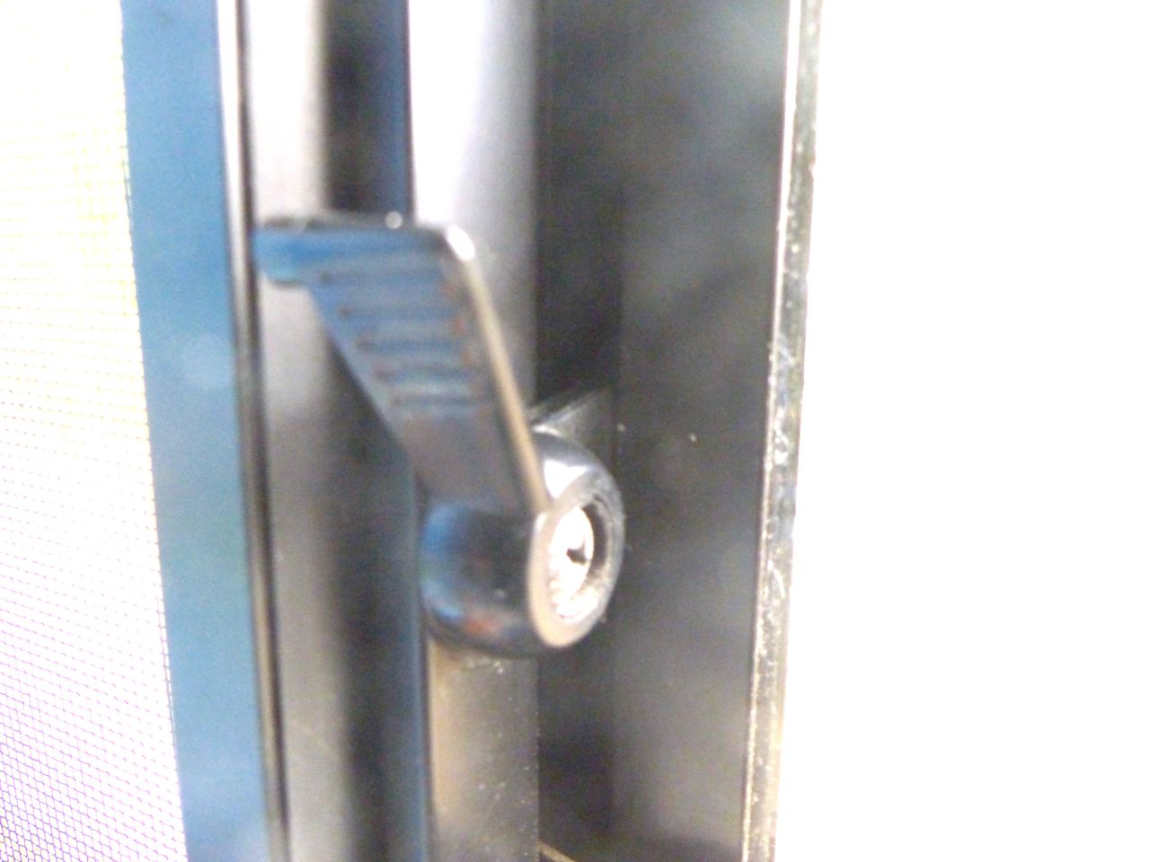

Sorry about the horrible quality of these photos. For some reason I can't get the camera flash to work. I lightened them up as much as possible to show the sweep latches (which are exactly the same as the discontinued Parkin ones shown in the previous post.
The main thing to note is that all that happens is the latch catches the *full length* groove on the rear edge of the fixed part of the window. So basically *anything* you shove into that groove will stop the window from sliding open. You could probably jam a popsicle stick in there temporarily. Or later make something that will rotate on the screw like the originals did. If it's tapered than it will wedge, like the originals. (Those metal ones I linked to above do look identical though, at least in the photos - might be great.)
First photo shows the "empty" screw where the one latch of mine that broke used to attach. You can also just see the top edge of the 4700 "pound-on" handle.
Next you can see the sweep latch itself. Here it is part way "open" and not latching the window. It will continue to rotate "open" so the arm doesn't stick out like that normally. Just like in the discontinued Parkin photo, there is no "second wing" like on the newer handles. It's shaped just like the generic-brand silver metal one in the last post. I tried to show the groove it goes into to latch, but as you will see if you look at the window, it is not any special small slot or anything, but rather a top to bottom slot in the fixed part of the window. Easy target to hit
And another. Here it is most of the way latched but not completely.
