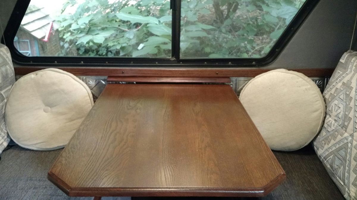

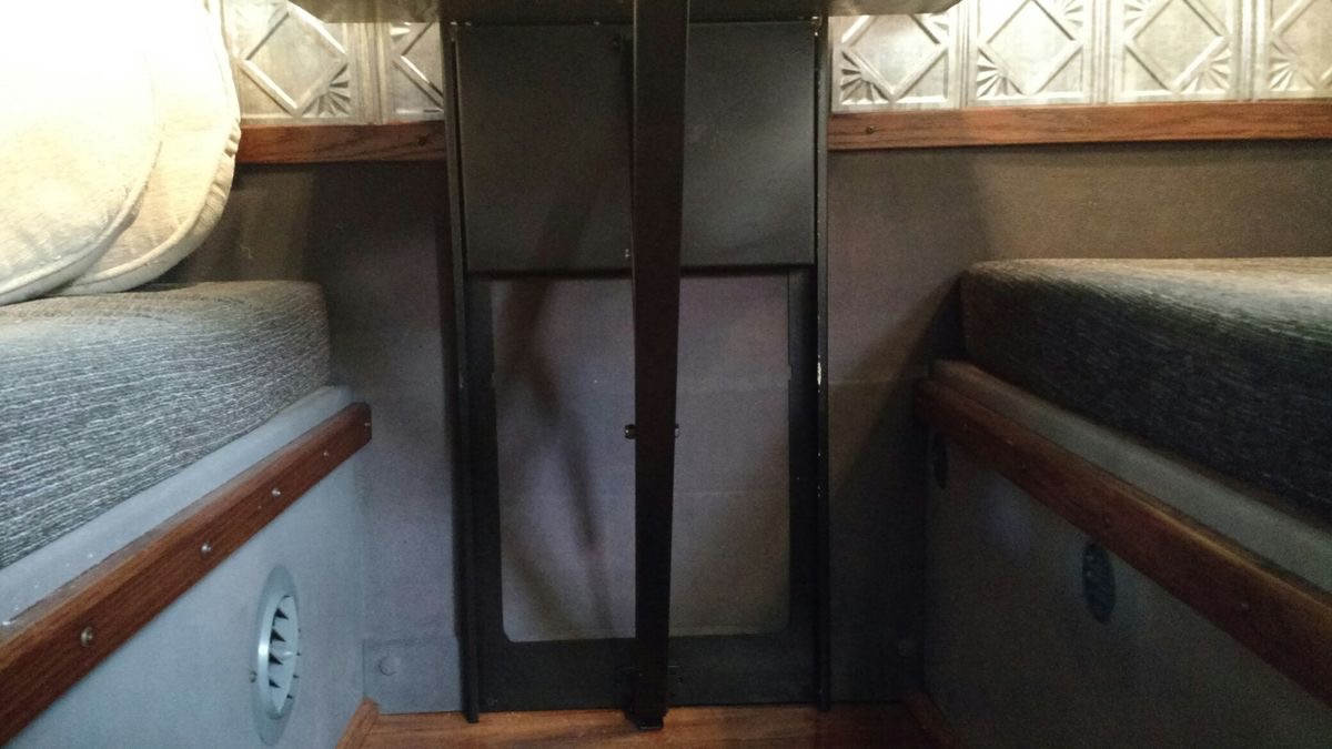

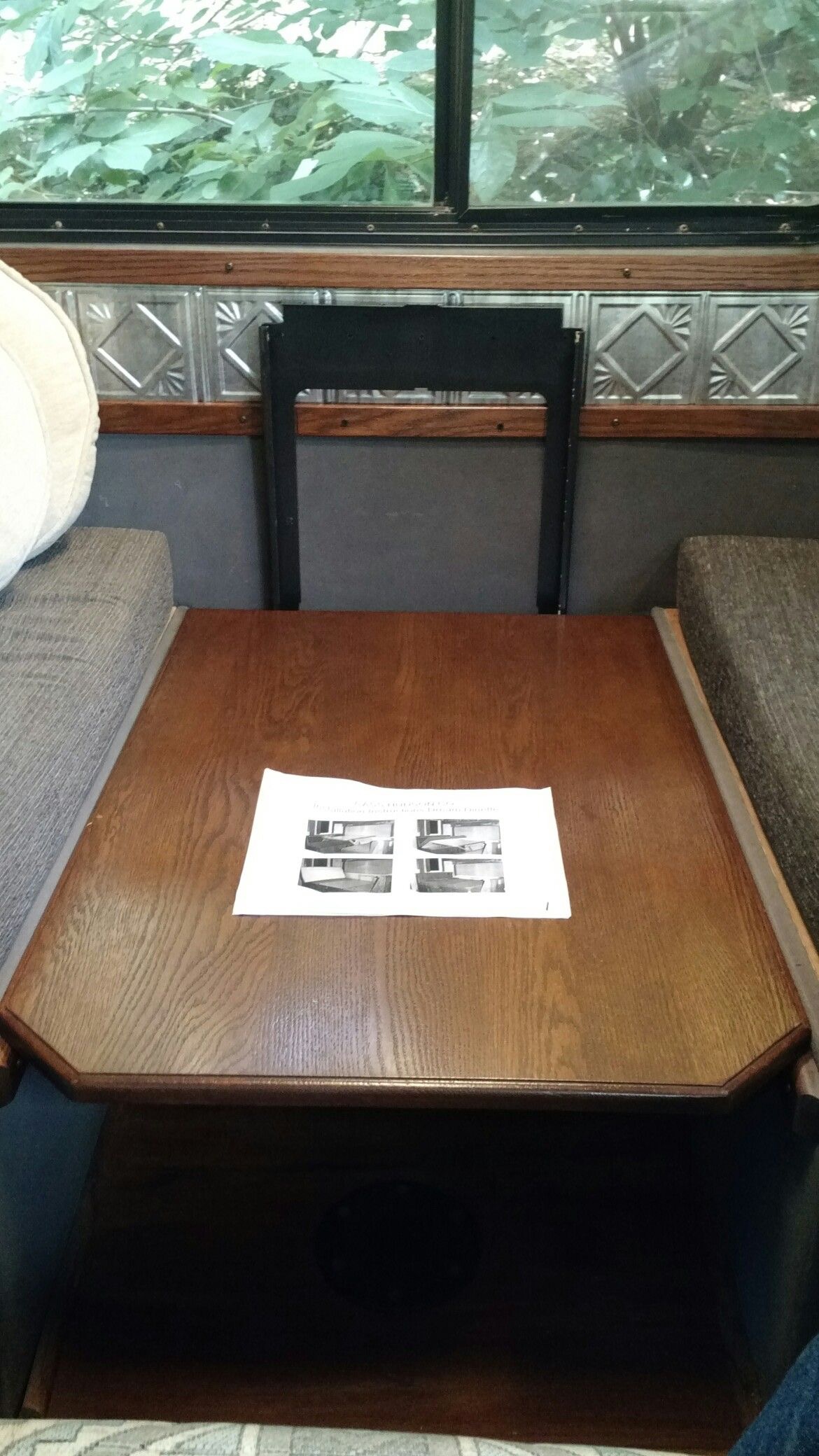

Mine came in just a few days, and I painted it dark to match my interior, and installed it today. Made a top wood trim piece for it, but still need to adjust it up another half inch...
Now even my daughter can lower the table to be a bed, by just flipping the lock lever and then pushing down on it.
To reverse, just lift it a couple of inches and the gas strut softly raises it back to table height.
On the downside, its arm splits storage underneath if you like to leave the table down, but this is a mod meant for those who raise/lower a lot.

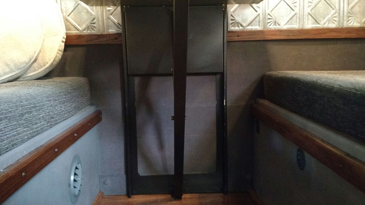

Of course, there was no way my Dream Dinette... as easy as it is to use... was gonna stay stock :D
So I replaced the gas strut with an 8" 200lb capacity linear actuator, wired to a power window switch I placed behind the dinette, and voila! Now I have a motorized dinette table -> bed.
Took a quick video before going to bed:
https://youtu.be/zYZOu_mKN04
