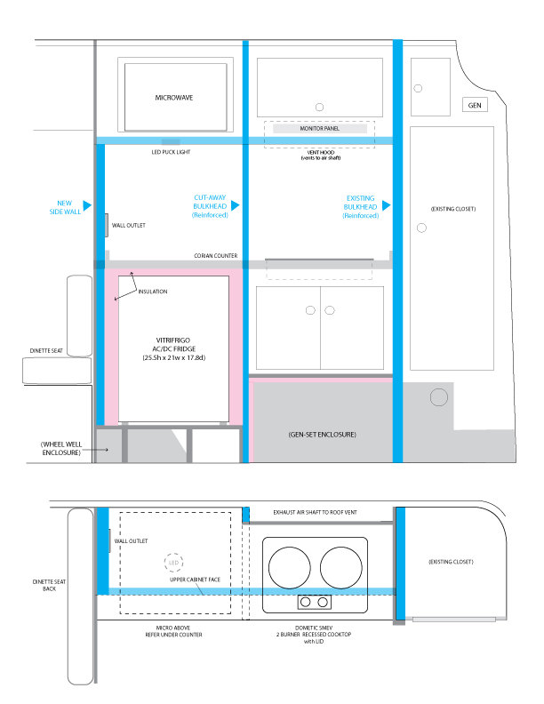

Like Blue-Go, I'm in the middle of a galley remodel. We wanted more room for the rear walk-thru area and additional meal-prep counter top space. Removed the ol'Dometic and went with the AC/DC Vitrifrigo. The smaller refer works for our travel style. It's similar to the size found in PleasureWays or Roadtreks. A new SMEV 2 burner cooktop w/lid replaces the original. Attached is a simple diagram of the layout (not CAD) to get the idea. Taking Blue-Go's advice, retaining the "bulkhead" wall is needed. I have also added a new sidewall (behind the dinette seat) to tie in the now "cut-away" bulkhead into the existing closet wall for additional support for the microwave. Construction is 2x2 "framing" with 1/2" ply. Retaining the original refer outside access door and roof top vents, a new "air shaft" will allow for the range hood fan to be ducted to the "outside" as well as aiding in the ventilation of the refers remote cooling unit. And... no more "limbo-dance" when standing over the stove
. Relocating the overhead cabinet outlet to the new side wall and adding an under cabinet 12v puck light was also done. I will be retaining the OEM style of cabinets/doors and Corian countertop. As Blue mentioned, the wheel well and gen-set enclosures presented the biggest obstacles when trying to figure a new layout.

Member "HoosierB" here is swapping the refrigerator and the stove [Edit: I see he posted while I was typing - great, now you get to see his excellent drawings and plans]. A couple things I can think of that you have to be aware of are these:
1) "Platform" under the current refrigerator (generator box) is around 13" high. Platform under current stove (wheelwell) is around 6" high. Presuming you want to keep the current stove area as a kitchen work surface, then you're limited in the refrigerator size by height. Yes, the current (Concourse) 31-1/2" counter heights can stand to be raised, but still. For example, my new 4.7 cu. foot (original was around 6.5 cu. ft IIRC for comparison) refrigerator is 31" tall. If I were to put it in the stove place, I'd have 6" for wheelwell, say 1" for insulation, 3/4" for "floor," 31" for fridge, 2" for insulation, 3/4" for countertop. So that's around 42" for the countertop. That's a bit high for me, and also crowds the upper cabinets a bit, but it might work for you (or you can find many smaller refrigerators).
2) Another thing to consider is, presuming you have a refrigerator with a built in compressor, you need space for the cooling air to flow. My refrigerator has a remote compressor, so I can put it somewhere else (within reason) but still need to supply cooling air (well, actually heat removal air).

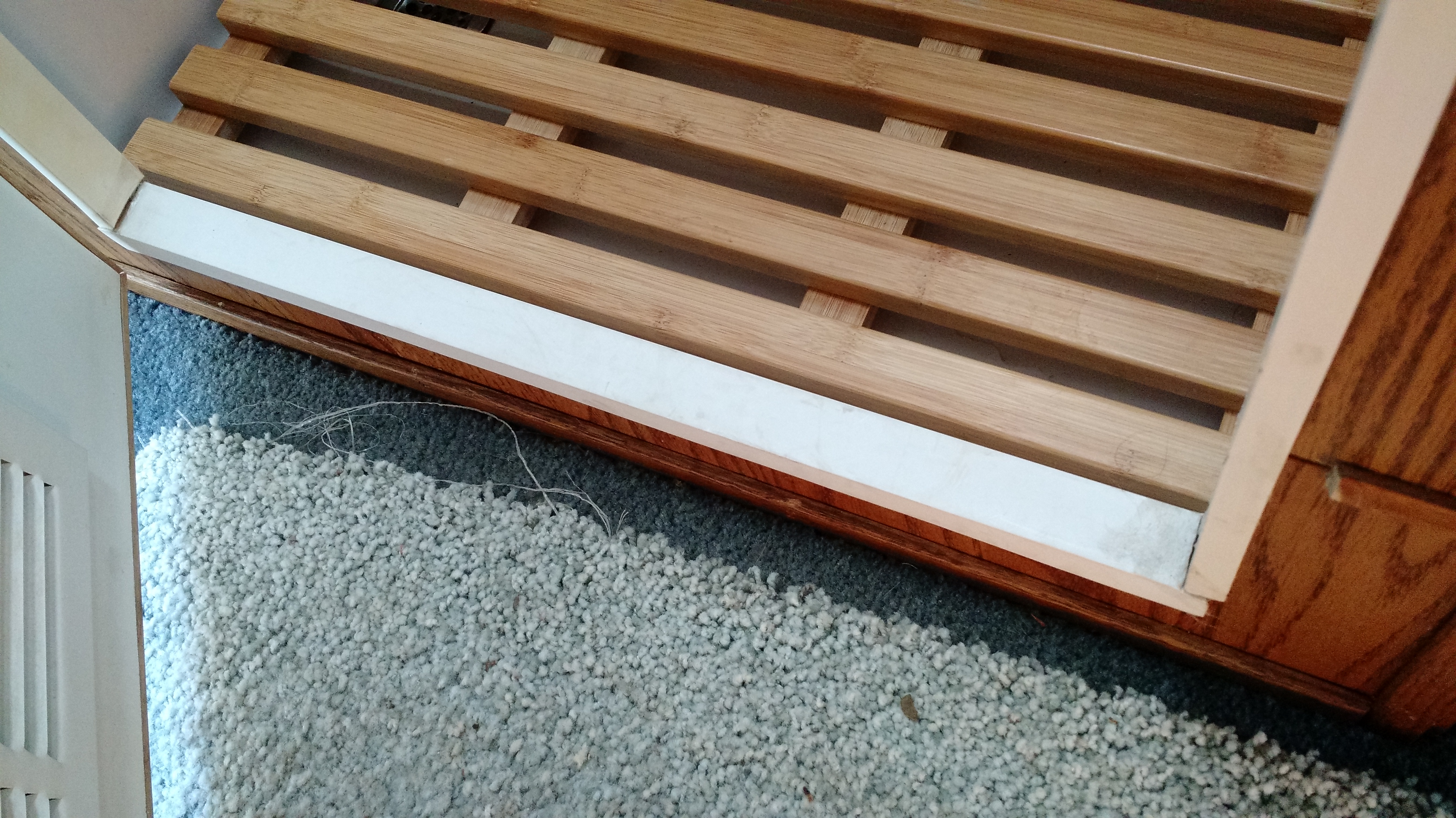

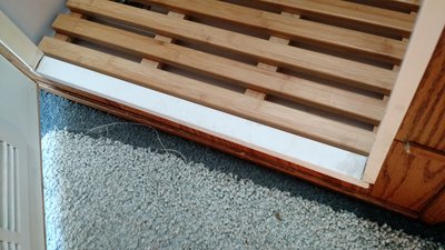

I recently replaced most of the bottom 6 inches or so of the MDF panel around the bathroom door, sink area and rear wall that was water damaged. Nothing matches the MDF oak pattern better than real oak! Since I was only replacing the lowest few inches, there was not a lot of surface area, and I used solid oak I recycled from some old drawer fronts I had in the shop. You can buy hobby pieces of oak at the hardware or lumber store or you can find some old oak furniture (end tables or drawer cabinets, etc.) at the thrift store for prices less than the value of the wood itself. I covered the seam with some molding, similar to the trim around the corners and seams in the Chinook already.THrunner wrote:Just catching up on this thread. These are some great ideas. I am looking to remodel the rear of my 2001 Concourse because the old panels have quite a bit of water damage from the fridge vent.
Does anyone have the CAD or measurements they could post from any of your remodels? I was hoping to drop in a slightly bigger fridge and I'd like to play around in the model.
Here is a picture showing just the bathroom door threshold: Clay

BTW: We use the microwave. I wanted to have the remodeled top cabinet/shelf extend outward no further than the passenger side overhead cabinets. This meant the new microwave could be no more than 13-14" deep. In addition, the original refer roof vent contour protrudes into the microwave cabinet ceiling area which effects the finished height for the cabinet. The minimal wattage we wanted was 900 watts. The smallest 900 watt microwaves I found were Haier and Frigidaire. Both had depths less than 13 1/2". Relocating the dedicated 20 amp recept to the "bulkhead" wall allowed for easier installation and more room for the new microwave.
