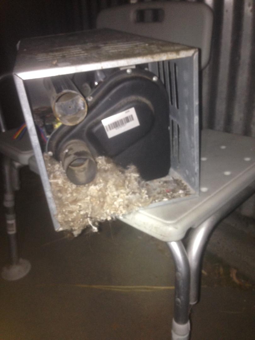

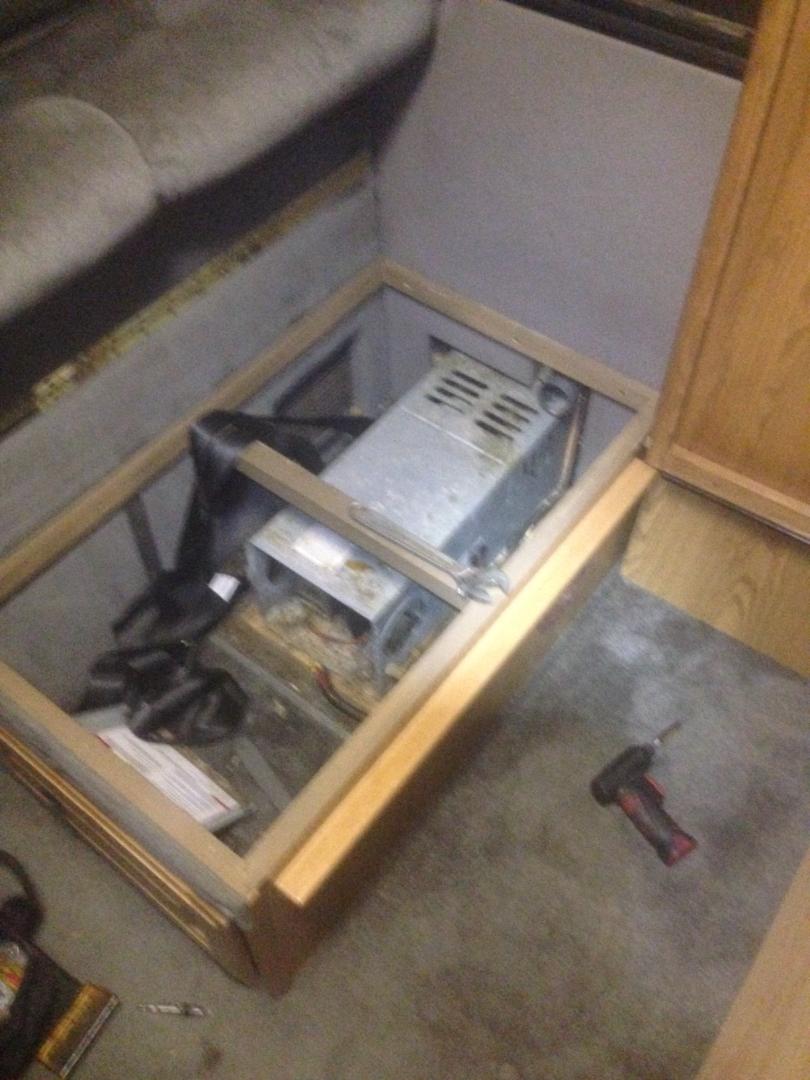

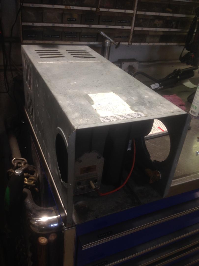

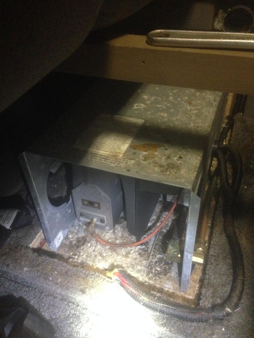

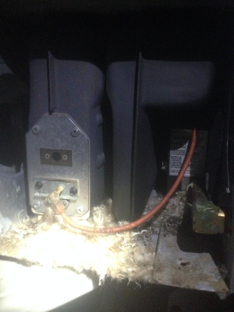

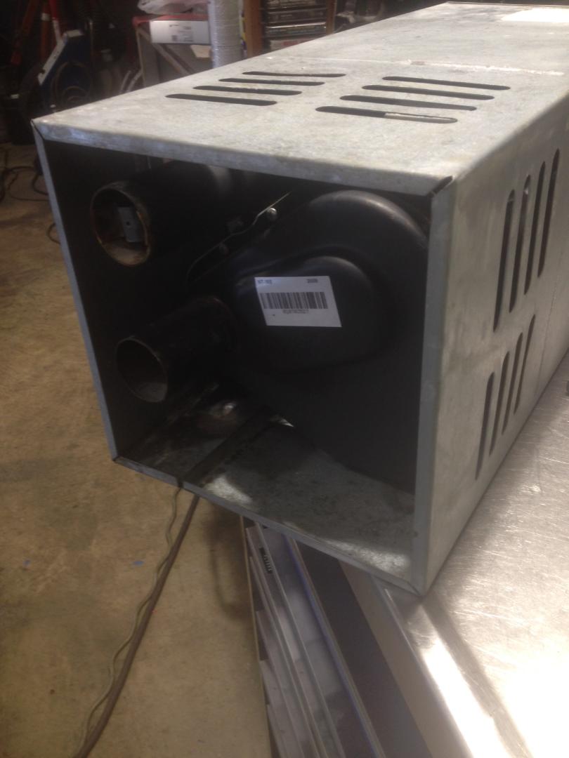

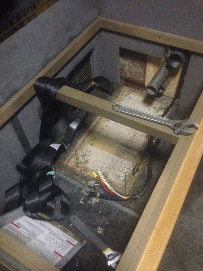

I see now what you were talking about. I removed mine from the inside like you did. I almost took the inlet/outlet out of the body, but I needed access to the space where the furnace was anyway so just did it that way. I did have to remove the partition between furnace and under seat storage area to give me enough room to pull the furnace out of the exhaust pipe. I ended up taking my furnace to work with me to tear it down. I was going to take pics of this process but it was so impacted by mice i figured nobody wanted to see that. I was contemplating chucking the whole unit and replacing until I looked up what one cost. Figured for 500 bucks Id give it a try to clean it up. Luckily the furnace have virtually no hours on it and wasn't all rusted up. I did remove the furnace from its metal box and chemically cleaned and brushed everything.Pulled the cover off the intake and cleared away the mud dobbers nest and tried lubricating the blower motor shaft. ( I figured it was a sealed bearing/bushing but a lil extra lube on the outside couldn't hurt) I can provide details how to disassemble the unit if anybody ever wanted to know. Its all back together now and no mouse smell at all and its been sanitized so I think im going to give it a run. Will replace all the ducting and flanges as well. Been waiting for some rv/boat chemical odor eliminator to show up so I can finish vacuuming / spraying and maybe steam clean the carpet in the furnace area before replacing back in and testing.

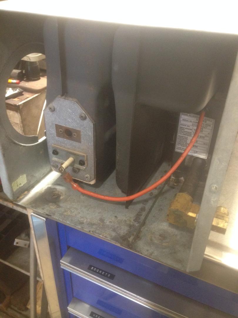

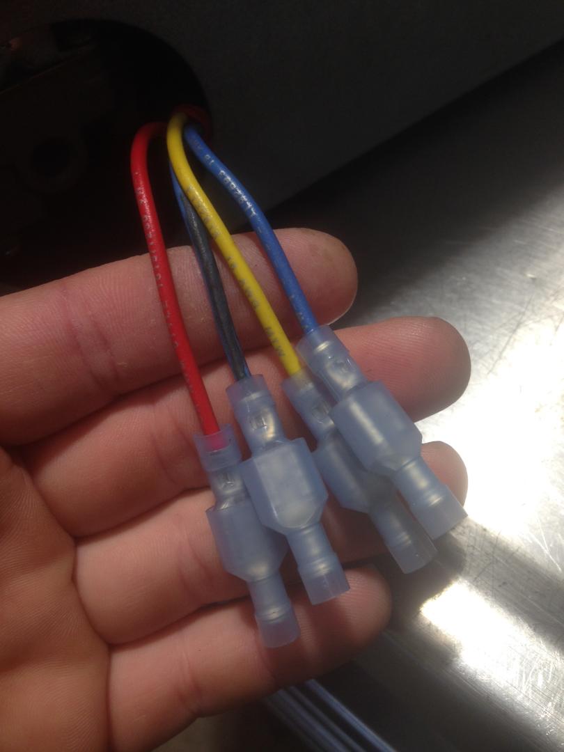

Yes, correct, I do have the dinette model. and the floor is lowered under the furnace. Ill go ahead and post some before and afters. I didn't get any pics of then I have the furnace removed from its box, but it does slide out for servicing / cleaning or getting to the sail switch. I am happy to report that so far the furnace passes the smell test. it smelled something awful before, but after all the scrubbing and disinfecting, I feel confident enough to try it out. Gotta have heat, we mostly dry camp and the gf is cold ALL the time. I have also hid the fact the furnace was so impacted with mice cause again she would freak. ( a real camper she is) haha, I also ended up just snipping the wires that came right out of the box vs undoing the factory crimp joints and un-looming. This was my solution using weather proof plug type connectors so in case I need to remove again I can just unplug the unit. These connectors are shielded on both ends.
Rich

connectors, the black looking wire is the other blue I just marked with sharpie to keep track

Good idea on the connectors.
