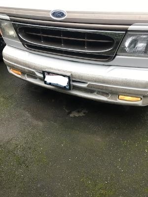

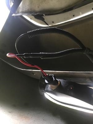

A cold wet dreary day here in Seattle but I repaired the light bc I'm doing a day trip this weekend and I like to drive with the fog lights on.
Easy enough to splice together once I had all the right parts.
The lens looks brighter because I cleaned and polished it, but it's the same bulb as the other side. I will polish that one as well.

By the way, the bulb is Sylvania 893 basic halogen lamp12.8V, 37.5W.
The high temperature headlight socket is Novita SC08.
Both at AutoZone for less than $20.
