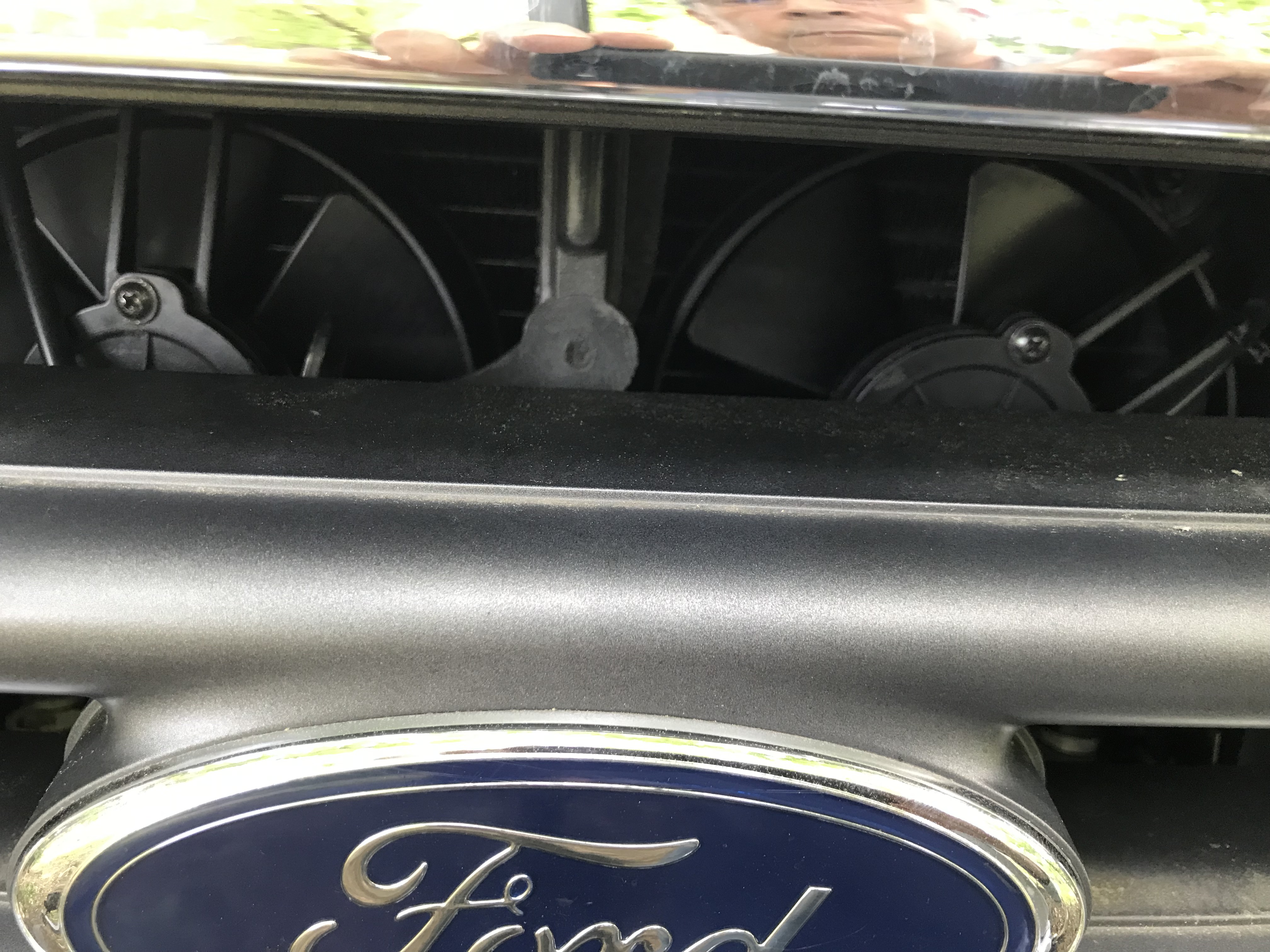

After a good bit of experimentation involving 4" pvc pipes mounted to my front bike rack in an effort to get air directed to the front grill (blocked by the covers that are necessary to protect my electric assist Copenhagen Wheels), I decided that a better, and much more elegant solution would be to install "push" fans on the plate and fin transmission cooler that is mounted in front of the AC condenser. Given the dimensions of the trans cooler, and the position of the hood latch (including allowance for "swing" when hood is closed, the largest fans I could mount were a couple of Spal 5.2" "push" fans that push at total of 330 cfm. (see picture attached).
I mounted the bikes this morning and went for a test run on The 90 for a couple of hours to see how this worked. It was sunny and about 72 degrees. I drove for a couple of hours on the interstate and then spent another hour cruising some hilly back roads. The results were not as good as I was hoping for, but, I think the readings are "good enough"--as long as I am sure to change the transmission fluid every 25,000 miles or so. By that I mean, I don't think these readings will cause me trouble.
The water temp reading on my scan gauge II ran between 204-211 with some spikes up as high as 224 before being brought back down by the radiator cooling fan. And the transmission fluid temp was consistently between 195-200 with a few spikes as high as 204.
I would be interested in hearing how this compares with the readings others of you might be seeing on your scan gauges...and what you think of those readings.

Re: Scan Gauge II, for monitoring engine/trans temps and more
Are the Spal 5.2" fan 5.2 inch in diameter? Thinking about the application on an armchair, here is what is going thru my mind. Let me know if it make no sense, or not logical.
At 330 cfm, it is a column of air 5.2 inch diameter, and 2238 feet long in a minute. That is like 25.4 mph in my calculation. So if you are moving faster than 25 MPH, it is not going to help you much unless the surface that you want to cool is completely/partially blocked off. Maybe the cfm will go up if you are moving, but I don't know if it really going to make that much of a difference. But if you are idling the rig, then it will be much better mechanism to cool since there is no much "natural" airflow.

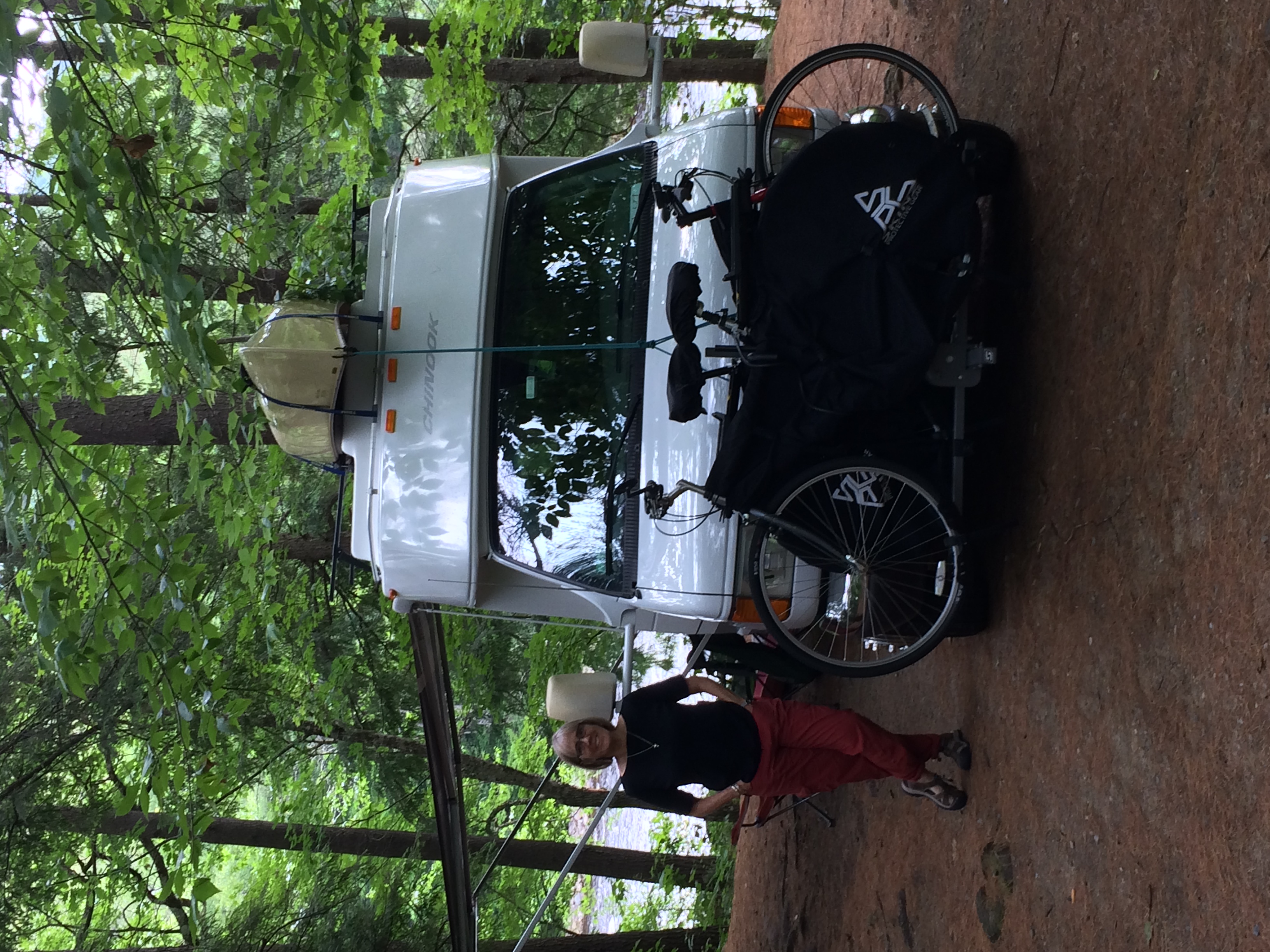

The Spal 5.2's are 5.510" in diameter. And thanks for giving me the calculation info of fan cfm to mph (I NEVER would have been able to figure that out...Political Science Major that I was). The benefit in my application is greater, due to the fact that air flow to the grill is indeed blocked by the covers for the bikes (see attached pic). The good news is that there is quite a bit of room between the grill and the bikes, so I have some air to work with.

My quest for lower radiator and transmission fluid temps continued this week, with, I'm pleased to report results that are much more (nearly exactly) in the range that Blue-Go just mentioned. First of all I ran the Rig up to NH with the grill wide open (no bikes) to set a decent baseline. In the 70's, I saw consistent 192 degree water, and 175 degree transmission fluid...transmission fans off at highway speed (thanks again Chin_k for your calculation showing that fans are basically useless at highway speeds).
Then, I mounted both bikes on the rack in front with covers--BUT this time, I put the back wheel (Copenhagen motor) on the outside) and opened up the cover in the middle to give a clear path of air to the grill. I had avoided this up to now because mounting the bikes in this manner was definitely covering the headlights. Thus, with a path for air to move through the bike frames (only back Copenhagen Wheel covered), I headed out to western Mass on the 90 to see what temps I would get with this new configuration. And, low and behold--I hit the numbers I was looking for: 196-198 degree water temp, with the occasional spike to 202 for a very short time (until the fan brings it back down), and a pretty steady range of 178-185 degrees on the transmission temp with an occasional spike (seemingly brought back down when the big radiator fan kicks in) to 190. Again, as per Chin_k, I am not running the trans fans at highway speeds...but I have found that when I run them below 45 mph, they do indeed cause the trans fluid temp to drop a few degrees.
SO, now all that remains is for me to install a good set of snow plow headlights (with turn signals) up high so that they can be seen over the covered bike wheels. Plan at the moment is to mount a front grill guard and use mounting clamps to install a set of Truck-Lite Snow Plow Lights (80800 or 80805). Once done, I think I will be in business, and we can put this tread to bed....or at least the part of it that pertains to transmission fluid temps!
Two things that you need to consider with the snow plow lights is to make sure they are DOT approved for highway, and that they are mounted properly (e.g., not too high that they will blind people coming toward you.) I wonder if there are clear cover for the Copenhagen wheels, or one with clear windows for the head lights? Or is it the hubs that will be blocking the light?

Chin_k...good/useful comments. I have only considered DOT-approved plow lights, and, in deference to my fellow travelers headed in the opposite direction, I ruled out LED lights as being just too damn bright. As for mounting...they will be mounted just above the top of the existing headlight lens...just high enough to project out over the covers, and I will work with my Ford Dealer to direct them properly (Ive had the good fortune to have a couple of good mechanics at the dealership take an interest in me and my RIG). The disk of the Copenhagen itself comes nearly 3/4 up the existing headlight lens, and I have yet to find anything capable of protecting my Wheel other than the Skinz covers I use (black). So, as far as I can figure, Plow lights it will have to be.
