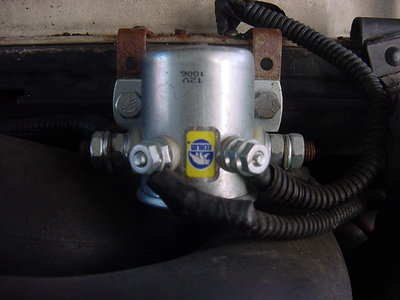

Thanks BG and Clay, I'm going to do as you suggested and disconnect the house battery and see what I have. It just sticks in my mind that the lack of a connection at the missing battery disconnect switch could contribute to the problem. However, I'm still going to have the battery bench tested, but I'll most likely get a new battery, maybe next spring, No sense having it set through a cold winter.
I still need to figure out which wires would be connected to the battery disconnect switch though. I'm reasonably sure that the yellow wire that runs directly to the positive post of the house battery, and the purple to orange wire that goes to one of the solenoids under the hood, are two of the wires that should be connected, I'm not sure which wire should be connected to the third post, maybe a whit ground wire?

Interesting! The newer solenoid on my rig has a grey wire connected to it, and the grey wire is also loose at the switches area in the dash, however, the left of my two older solenoids has a purple wire which changes to orange under the dash and is also loose. Like I have said, the loose yellow wire goes to the positive post on the house battery and is hot. The three post switch that I have gotten is a 12v, 20 amp, single throw switch, the posts are labeled as: "supply volts", "on acc", and "earth ground". What are your thought as to which color of loose wires would connect to which posts of the switch. I also have a loose white wire. So, in summary I have yellow, orange, gray, and white wires loose.
