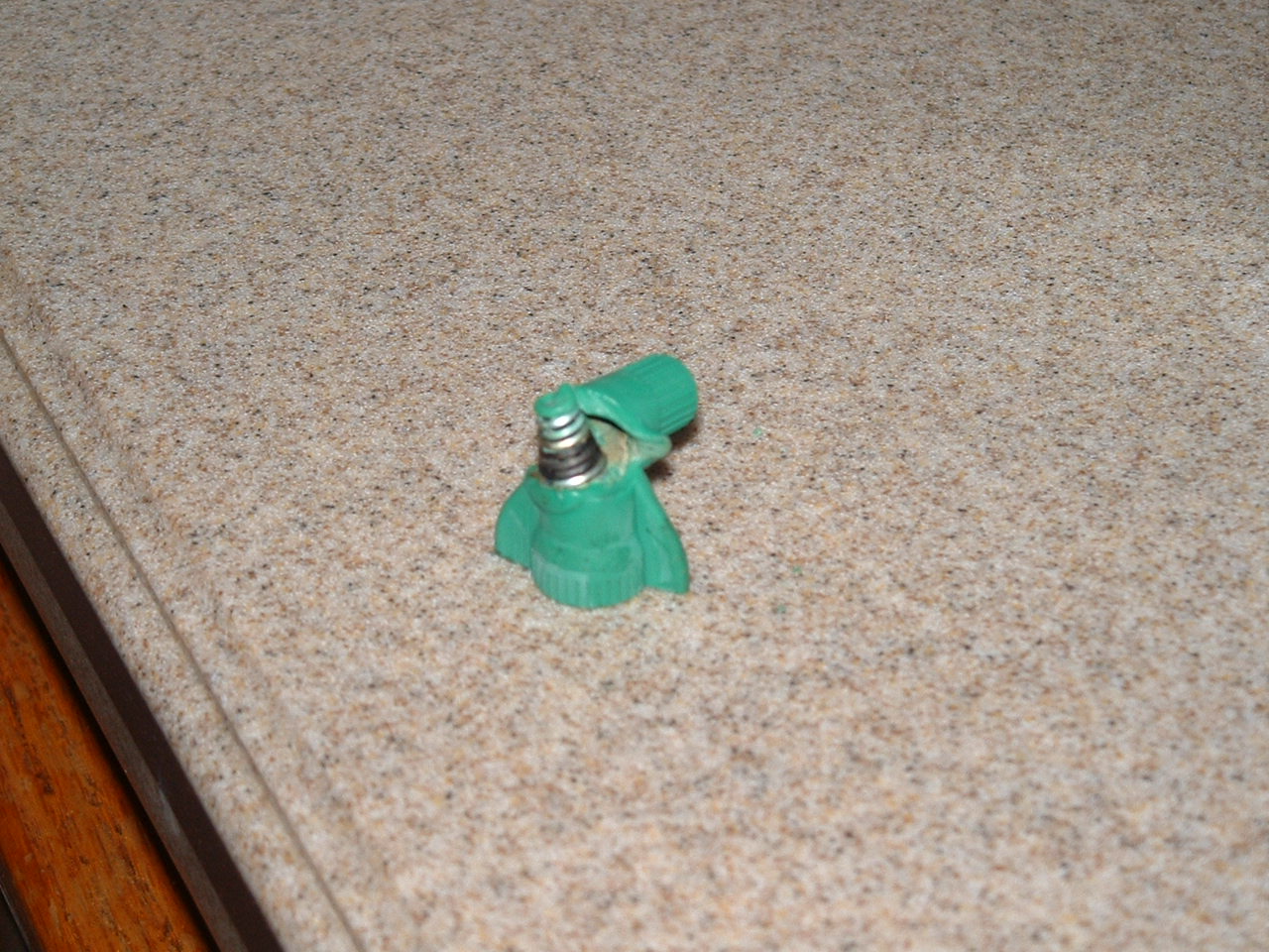

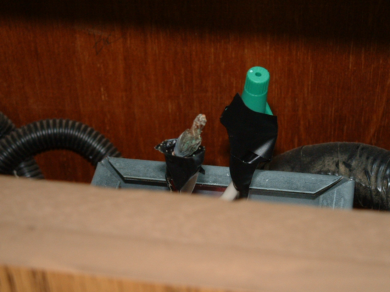

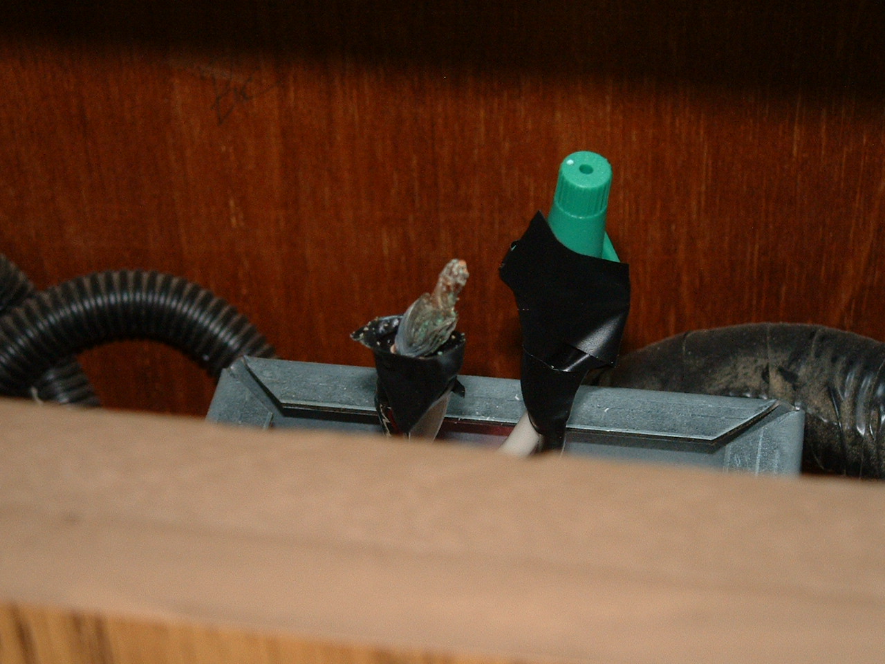

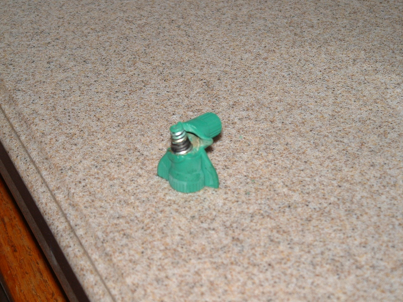

One other thing- I decided to check the connections from shore power to the back of the PD4645. The wire nut on one leg of the connection was melted and there was heavy corrosion on the wires- see pics. It was getting close to the end of the day and I had been messing with this issue since this am, so I did a quick clean of the wires and put a new wire nut on them. I was hoping that this was the source of my problem. But when I reconnectd to shore power still no charge voltage going to the batts!
Tomorrow I will check and clean all the connections to the PD from shore power and see if that makes any difference.
