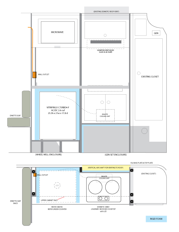

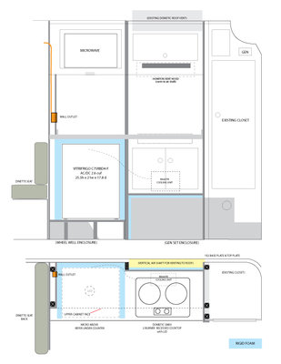

Re: 110 Volt Fridge
Hi Hoosier,
This is so far, just an idea I had. I do now already have a cabinet just below the original roof vent (when I re-did my cabinets I made both main sides "three units" long -- so in other words the above-stove cabinet is part of the main long dining cabinet, just like on the couch side). So I have a separate little overhead cabinet that basically matches the other ones, but is its own unit between the stove/fridge wall and the fridge/closet wall (hope that makes sense).
That location, and/or the area behind the wheelwell and under the stove are my two contenders for compressor location.
But as mentioned above, I don't have an easy way to make a ventilation chimney, AND a watertight lower vent hole because my refrigerator is going to be fairly tight to the outside wall there.
So yeah, one of my thoughts was, well, this is NOT a "fireplace" like the absorption fridge was. No combustion is occurring, and no flames are burning. The stand-alone portable refrigerators (like the CF-50 I've been running the past 2.5 years) just have open holes on each side - one intake and one exhaust (and I calculated - they are almost exactly each the 25 sq. in. recommended by Danfoss).
So.... what if I ONLY used the roof vent? It's relatively huge (I have yet to calculate the open area though), doesn't seem admit water, and is right above one of my optional compressor locations. Two things though: One, is that it's important to separate the intake and exhaust air (so the intake can't suck in the "pre-heated" exhaust air), and two is that while the exhaust would have a natural heat-rising nature, the intake would be pulling air down -- maybe that would want assistance? I don't know. As I think about it, probably no big deal since the fan that comes on the compressor already does suck air in (vs. pushing it out at the back).
As far as a septum, I'd just use a piece of thin fiberglass board or something like that to make a vertical divider. I can't remember right now which end is which, but basically the compressor is shaped like a shoebox, and one short end is intake and the other short end exhaust. So a septum that ran east-west and divided the long, narrow roof vent into two squares is what I was thinking.
But all that said, I'm starting to think why not just use inside air for the whole shebang? No holes, no dust being sucked in on back roads (to the compressor), no nothing. Yes, it slightly adds heat to the rig in hot weather (although that would be even less with your smaller unit), but at least for me, I'm probably just as often camped in cooler weather where I'd welcome a little bit of heat (it's not much).
So then I'm back to the compressor next to the wheel well under the original stove area (which would be just under your fridge, so maybe you have no room for insulation?). Intake at the floor area, and easy to build a hood for that (to only allow "room" air into the intake, not any of the exhausted air), and then let the area behind the oven or drawers be the chimney, then make a little raised backsplash that has an outflow crack (1" x the 25" wide of the counter equals the 25 square inches). Reason for that is so the crack is not at counter level and letting crumbs or etc. fall down.
You may not want to do it there since you'd have the same issue as me in the fridge location - why sacrifice depth where the refrigerator is (which would be you in the stove location). But maybe in the next compartment?
So upshot is, although I can think of a number of clever ways to do the exterior chimney venting.... I'm not sure it's worth the trouble and holes, especially for a non-huge refrigerator (less heat in any case than a larger one). No way to prove that one way or another, just thinking out loud...
Re: 110 Volt Fridge
I agree that you could get away with closing both absorption vents entirely and just cool the compressor with coach air. The amount of heat added to the coach would be basically equal to the heat removed from the fridge, plus the heat generated from the mechanicals and such. As we've learned from Paul in this thread, a functional cooling fan is most critical. Fortunately there are millions to choose from, they cost nearly nothing, they use very little power, you have pusher/puller mounting options, and a power source right there. Unrelated, I have plans to experiment with a little fan inside the fridge to help distribution; the wires for the fridge light should make it easy to hook up.
If I had a remote compressor (refrigerator envy), I'd mount it up above, source cooling air internally, and then implement a manually-operated baffled duct so exhaust can be directed out the roof vent or kept in the coach depending on weather/season/dust. The space behind the wheel well makes sense too, but I like that area to store heavy stuff like canned food (tuna and sardine addict) because it's low and isn't a flimsy shelf. I'd also mount it such that I could easily access the cooling fins so I could keep them clean.
Regarding dust, my upper fridge vent is as stock, and the lower is blanked off. I have a black fridge, and I'm on dirt roads all the time; yeah a little dust gets in, but it's a small percentage of the overall mess that enters just from regular use. Of course, that's all relative. I like it open for air circulation, but I'm going to blank off the upper vent this winter, but mostly just for warmth reasons. I don't expect I'll notice much difference though. Sorry if I'm butting in (since my residential fridge doesn't have an external compressor, the coils are in the walls, and there's no fan). Just wanted to share some thoughts/experience

Installing my new fridge in the old stove location necessitated a small "access hole" be cut in the lower portion of the original forward vertical fridge wall, which is now a somewhat modified reinforced septum/support wall in my remodel. This access allows just enough clearance to slide the remote compressor in and set on top of the gen-set box by the lower outside access door vents. A cover panel for the access hole will be screwed in place and have proper grommets for the supply lines. Service for the remote cooling unit is by way of the OEM outside vent door or inside via the new stove top lower cabinet back panel. This remote compressor location offers quiet operation and allows for a "natural convection" ...fresh ambient air intake and exhaust air rising/exiting thru the air shaft/roof top vent.Blue~Go wrote:And now you've re-kindled my desire to put the compressor up by the ceiling. It would intake warmer air there (vs. the cool floor) but maybe not that much warmer. OTOH, where it would be an annoying challenge, is in constructing the cabinet and getting it up there. Reason is that the copper line to the refrigerator box is not detachable, but of course who wants it dangling at the front of the cabinet. Of course it can be figured out.
...in theory...?
The plan...
