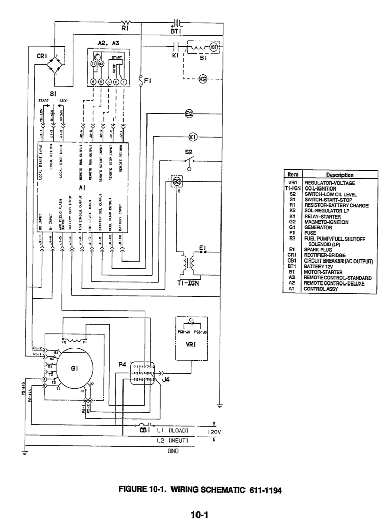

Blue~Go wrote:Oh good point on my annotations. Since in my mind I know that power only goes TO the generator from the start battery (whether that be house or Ford start), I didn't think to make the arrows go the other way!
Turns out things are not as clear cut as we all thought. The common internet wisdom is that the Onan only outputs 120 AC, and thus the coach converter / charger is always responsible for recharging the starting battery. But what about those of us who start from the Ford battery?
I just found out that the KY Spec A generators DO have an internal 12v output that feeds back 1 Amp to the starting battery. This takes over for ignition and control board power from the starting battery once going. Later Specs do not have this DC output.
(The Spec is the last letter of your Onan model number, which starts with 4KY. You do have photos handy of all your appliance model plates, right? If not, then you have a weekend project! grin. Generator, water heater, fridge, under AC filter, etc.)
So if the starting battery is the house battery as is the case of 2000 onward Chinooks, or if the chassis battery can be charged from the AC converter /charger like later Chinooks with a separator /combiner (beginning ???), then Spec B and higher Onans without DC output are fine... as their AC output will be used by the coach system to recharge the starting battery and help power the ignition.
OTOH, my 94 Chinook uses the chassis battery for starting and has no way for the coach system to recharge it. So it has an Onan KY Spec A with internal 12v feedback to the starting Ford battery.
Here's the Spec A circuit. You can see the 12v AC winding takeoffs (B1,B2) from the generator (G1) at lower left, which go through a DC rectifier (CR1) and charging resistor (R1) back to the starting battery (BT1).
Learn something new every day! This info should help with debugging older Chinooks.
