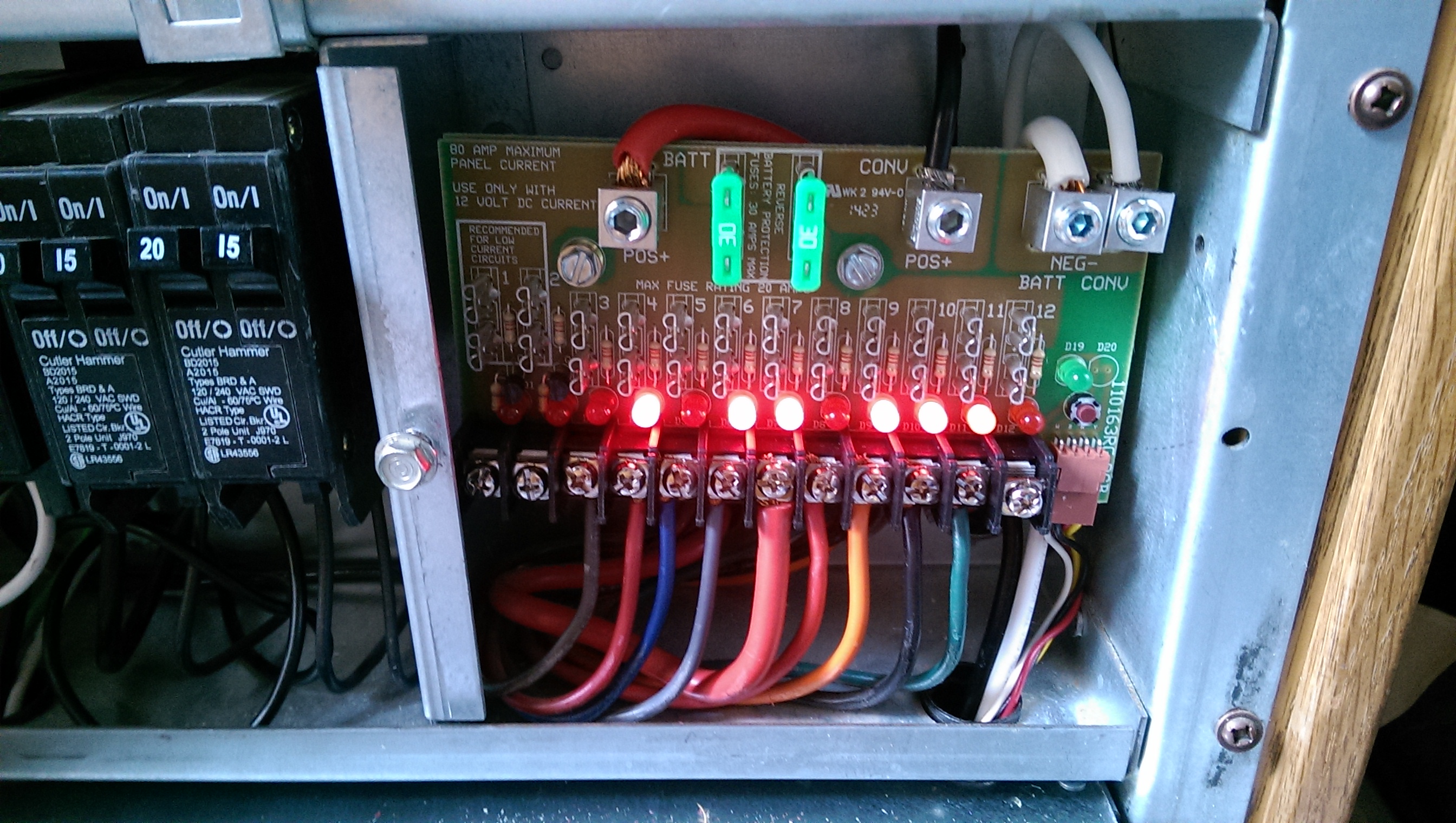

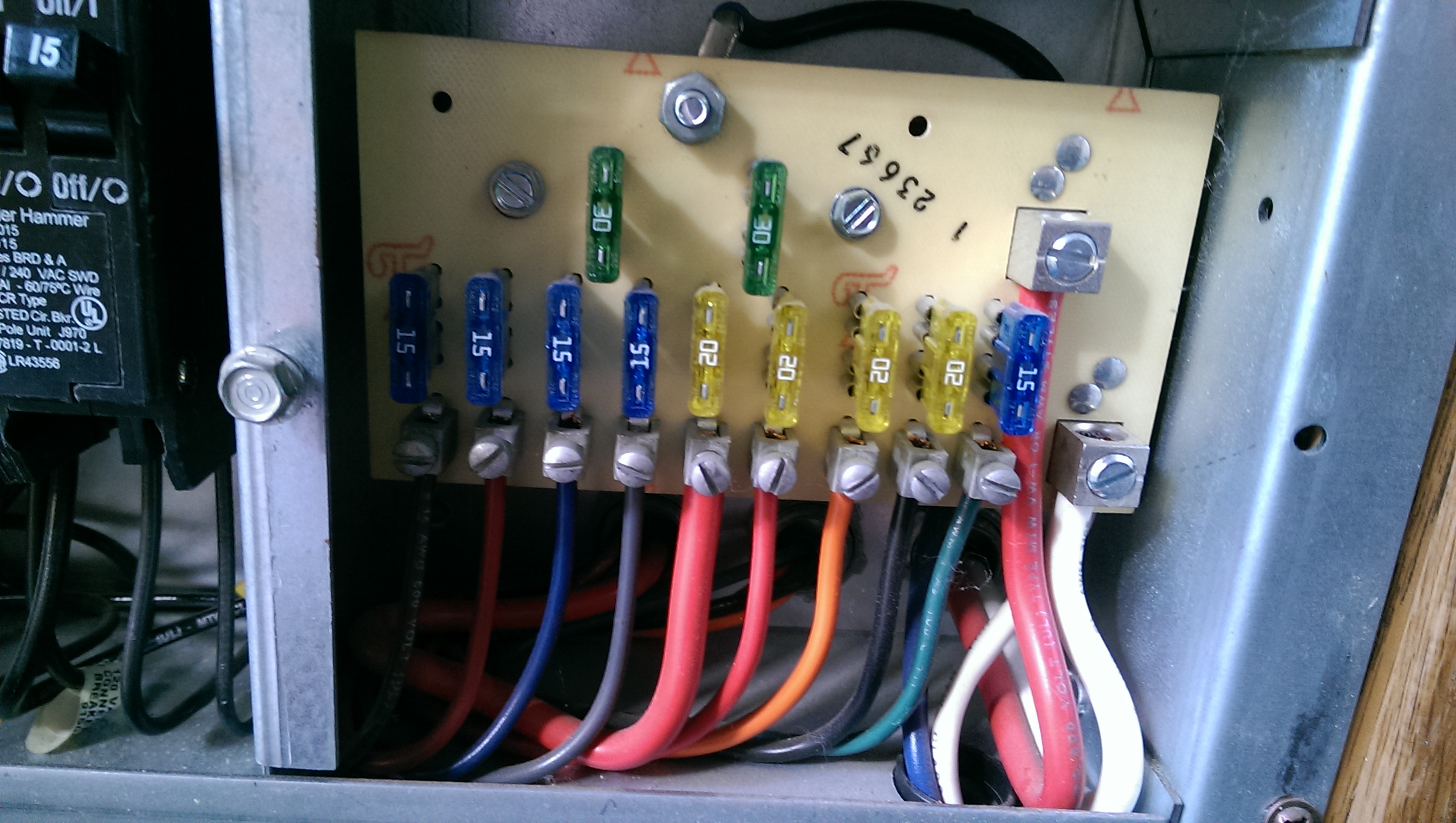

There is a fuse for the refrigerator circuit in the DC distribution panel (in the brown converter box under the sink, generally) you should check. When you open the breaker panel, the AC breakers are on the left side, and the DC fuses are on the right side. Here is a picture of the old Magnatek DC distribution panel:deb wrote:Thanks Ted.
Light up top over driver is on.
Everything works except fridg.
I will report on fix when I figure it out.
d.
The refrigerator wire is the big red wire in the middle, with a 20amp fuse above it. If your converter has been upgraded (hopefully it has been), the DC panel may look like this picture (fuses are removed from the panel in this picture, but would be placed above the wires like in the old circuit board):
or if your unit does not have a converter like this there may be a different DC fuse arrangement.
