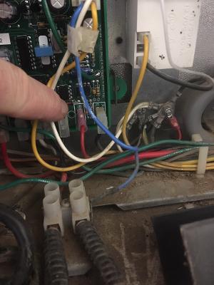

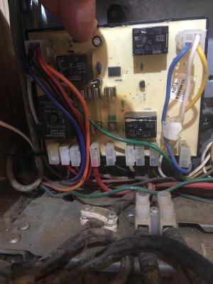

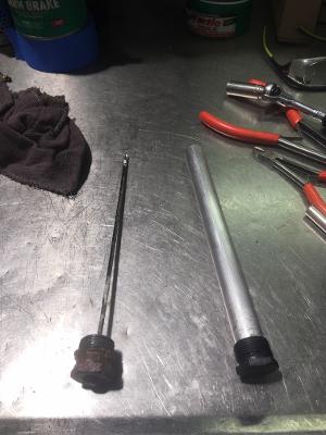

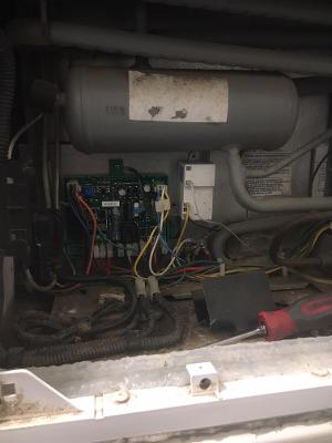

I received the dino board and installed it this morning. I think at this point I will say this is a confirmed fix. Good instructions came with the board. I did have to make a new ground for one of the pins on the board but that was no big deal. Once install was complete I powered the fridge on and it came right to and auto selected AC and hasn't kicked off. Freezer was already down to 5 degrees and fridge down to 33 about an hr ago. I am going to let it run all night through tomorrow. The same time I ordered a new anode for the water heater since I didn't know when it was last done. Glad I did :lol:
old vs new anode
old vs new anode
added ground to junction
added ground.jpg (20.78 KiB) Viewed 44177 times
new circuit board
new circuit board
new board.jpg (15.54 KiB) Viewed 44177 times
original circuit board
old board.jpg (20.92 KiB) Viewed 44177 times

Looks like you got your money's worth out of the anode rod there! :D

chin_k wrote: March 16th, 2021, 1:50 pm Looks like you got your money's worth out of the anode rod there! :D
I am almost a 100% sure the original owner didn't know there was a sacrificial anode that needed to be changed out annually. Luckily the water heater has low hours on it so there wasn't a ton of water flowing through it. I used my water heater wand and de-scaled the inside of the tank. Did get a fair amount out of it but i am hoping no real damage occurred. Hey at least there is a fresh rod in it now. I have never seen one that didn't have SOMETHING on it :lol:

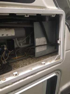

Thanks for the heads up about the recall campaign, This is what my flue area looks like. Is this the recall shield?

Edit: Nevermind. The pic shown up after a few seconds. It looks like the one that has been installed. I would check the label on the shield to make sure it has the updated label. Anyone else who can confirm will be good (I just do this from memory of what mine looks like.).
Re: Fridge acting funny, thoughts
Yes that looks like the shield. I remember somewhere there was a before and after picture but I'll be danged if I can remember. I think I googled it.
Ideally, we should confirm the recall upgrade by calling Dometic. They keep the record of which rig (VIN) has the recalled performed, by whom, and when. There should be label on the shield, but I am not sure. If in doubt, get it from the horse's mouth :D
