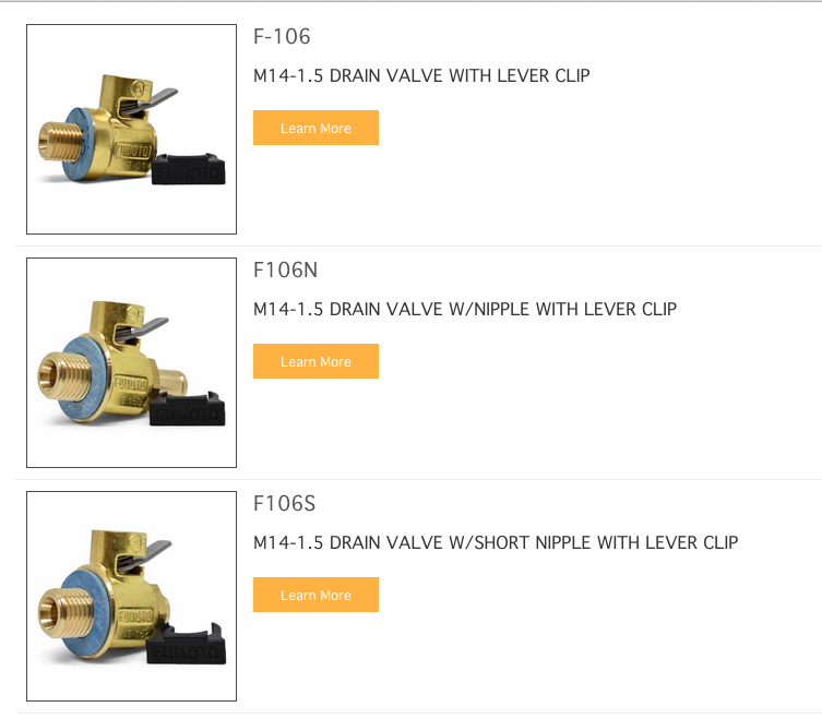

BTW, if anyone is interested, for the V-10 the model is F-106, then you add an S or N if you want either the short or long nipple. I see they come with a clip now (used to be optional).
There are some other options, but I'd say don't just assume they'd be better. My car was tricky to fit so I first thought that one of the "fancier" models might work better, but as it turned out nope, that would have aimed the oil flow in the wrong direction.
The F-106 does work well. Since this was my first Fumoto and I went on a friend's recommendation I have the flush one with no nipple. I would prefer the F-106N and may change it. I have the "N" model on my car and it's so much easier and tidier. (I wouldn't feel that way if it hung down in the way of brush or whatever, but it doesn't really do that on the V-10 oil pan.)
This link will take you to all the options:
http://fumotousa.com/results.php?make=1 ... y+6.8L+V10
PS: One other nice benefit I meant to mention is that you can drain off a small amount of oil, which is not possible (at least not for me!) with a conventional oil plug. This can be handy if you sample your oil for testing, and/or if you (or a shop... ahem) accidentally overfills the oil level.

The Fumoto valve I have is the F-106 (no nipple). This was the first Fumoto I ever had and I just went on someone's recommendation. If I were to change it (and I might), I'd go with the Fumoto F-106N. Difference being that the N has the long nipple. I have the N version on my car and it is SO EASY to change the oil without making any mess. You can practically do it in office attire. And you can direct the oil (via a short hose they supply) to a container with a small opening (water jug, large jug oil comes in, etc.) for disposal. This way I don't need to carry an oil change pan.
On some vehicles I would worry about the N version hanging down and catching stuff. But on the V-10 the plug is somewhat tucked up, and the nipple doesn't hang down anyway (it goes over on an angle).
They also make an F-106S which has a shorter nipple. Then you can put an elbow on it to accept the hose. But I'd choose the F-106N if doing it again, then use just the little hose (which is what I do on my car).
All the F-106 look like they now come with a clip to make sure they never open accidentally, but that used to be optional and neither of mine have it (because I bought them back in the day). I could buy one now to add if I wanted to. Once you operate it on purpose you'll see that it's not easy to "undo" (I mean it's not hard when you want to, but it's not like a blade of grass is going to open it). But if I buy a new one I'll add the clip, just because why not.
Maybe I wouldn't put one on an offroad Jeep, but I can't see taking my Chinook through anything that would rip off/open the Fumoto. So many other things to break off down there! Also, I have one on my car and I'll take that through MUCH more than my Chinook. So far, so good (100k). But it's a personal thing, and if it was going to cause me worry I wouldn't add one. A plug is a plug. I'm happy with it and would add it to any new vehicle (unless it had some arrangement that made the Fumoto "stick out," which the V10 doesn't (neither does my car).
Looks like you'd be under $30 for the whole shebang. Also looks like some places give you the clip with it, and maybe some sell it separately, so just check. I'd also get the hose (or buy a different hose - just have one).
The valve comes with a blue fiber crush washer. I think that's what's on my Chinook (I traded a friend installing the Fumoto for some work on his boat, so I didn't put it on) and it has never leaked. On my car the research said that maybe the car's original crush washer (but a new unused one of course) might fare better. The installation of the Fumoto on the car was tricky (had to use a crowfoot and swear a bit) so I wasn't taking any chances and used the original type metal crush washer. As I said, no problem on the Chinook plus install is easy so the stakes for choosing one or the other aren't as high.

FWIW, I got the short nipple version of the valve (F-106S), because it does not extend pass where the oil pan bottom. The normal nipple is not going to stick down much either, but I just don't see the extra utility of the longer nipple (easier to snap the hose on), since the short one comes with an adapter anyway.
I did not find any original washer, so I used the one that came with the valve. I think the plug I removed was probably not the original one, but I kept it in the rig just in case I need something to plug the pan in emergency (I know, maybe once in a billion years?).
