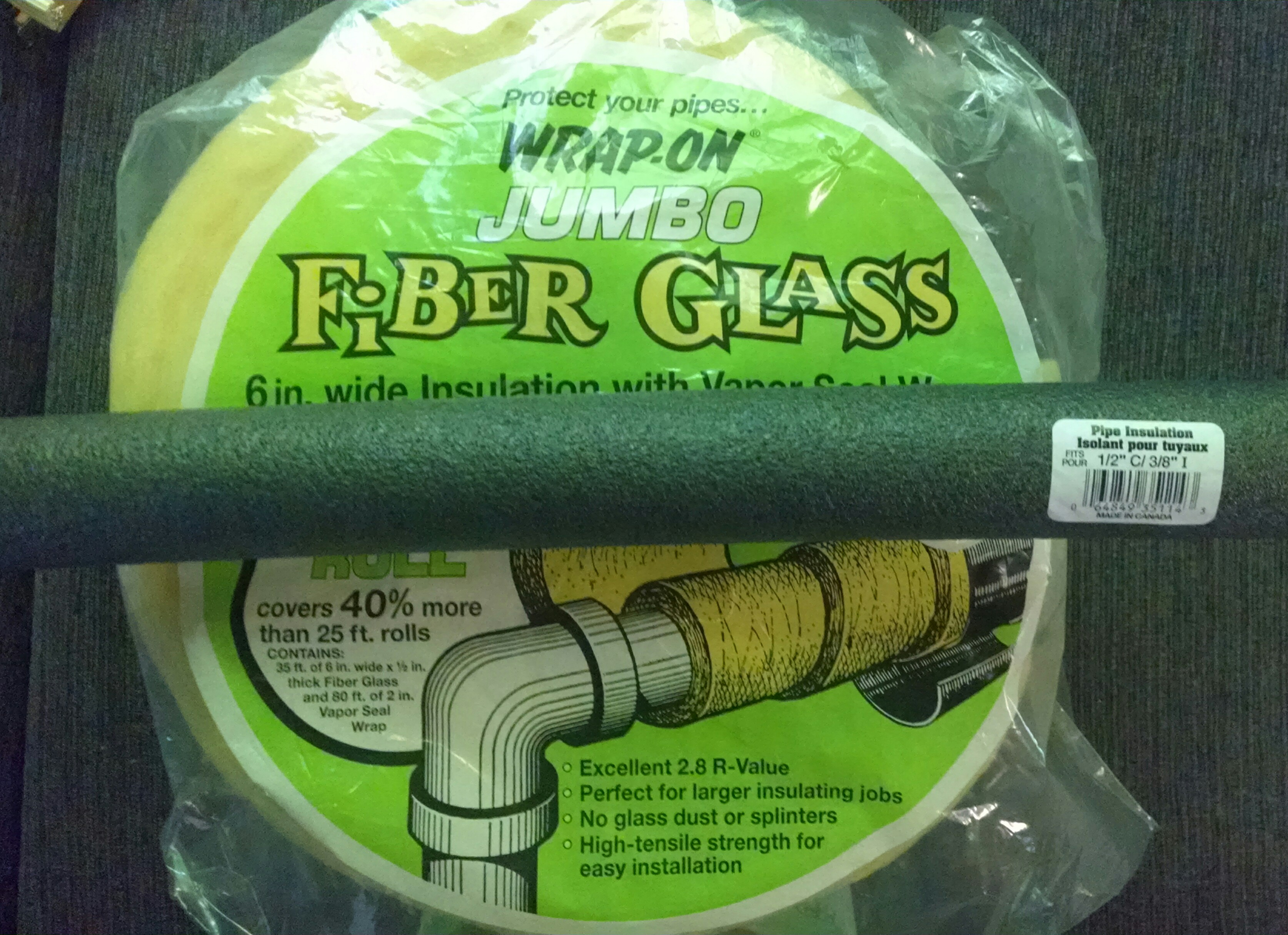

After seeing that my water heater has no insulation at all (while pictures I've seen of other Suburban heaters have what looks like a styrofoam casing), I bought insulation and pipe covering at Ace Hardware today.
I figure the insuation roll will help the heater, and the pipe insulation will keep the water a bit hotter on its way back to the rear. Will upload a picture after I'm done.
A while later... Okay, got a good start, Stuffed insulation all around the tank under its cardboard cover, and started covering the hot water hoses leaving the heating unit. I'm also going to add some insulation to the wall behind the kitchen sink around the outside water inlet box, which seems oddly bare.
I need to buy more pipe insulation though. It's a long curvy trip for hot water to go from the heater back to the shower!

Yes sir, it was a relief to find to discover that I wouldn't have to find a way to slide insulation onto pipes going behind the bath enclosure... while of course also being a bit of a letdown not having to do something really difficult (which I often find to be fun to figure out).
Oh. New test after installing tank and pipe insulation: Without increasing the new electric element's thermostat, I let it heat up for two hours this time, instead of just one.
Wow, what a difference! Hot water temp at the kitchen sink increased from the previous test's 104, to 126 degrees! Probably mostly due to tank insulation and extra heating time.
