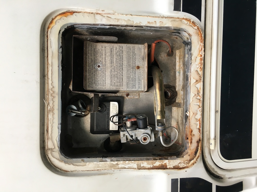

The first picture shows the tank bulging in the middle. It is showing sideways, click on it for the full size and correct orientation.

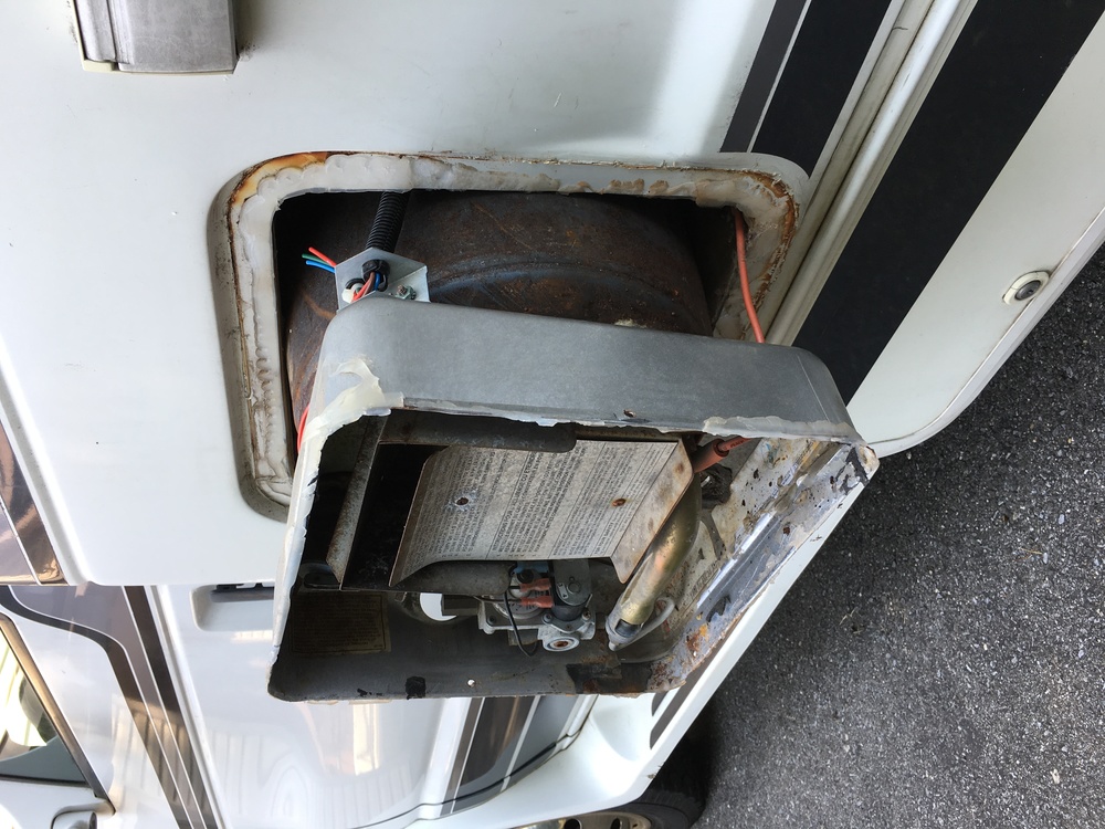

This picture shows the old heater without the frame. It fits okay around the edges, with a fairly consistent gap all around. It is showing sideways, click on it for the full size and correct orientation.

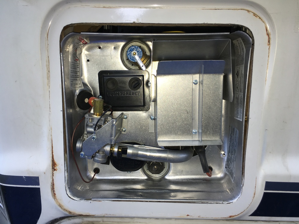

This last picture shows the new heater without the frame. You can see what a large gap there is at the top.

Oh, and getting my old one out was not so smooth or easy, as the tank itself had swelled over the years. I have no idea why that should happen, but it was obvious looking at the old one and the new one, that the old one was swollen in the middle. It was too fat to be pulled out through the hatch even after removing the styrofoam around it (a good 1/4" to 1/2" and fiberglass has no flex), so I had to remove it from the inside. But then the metal rim on the outside edge didn't have clearance to be pulled inside, so I had to rip that off and get it out through the hatch.
